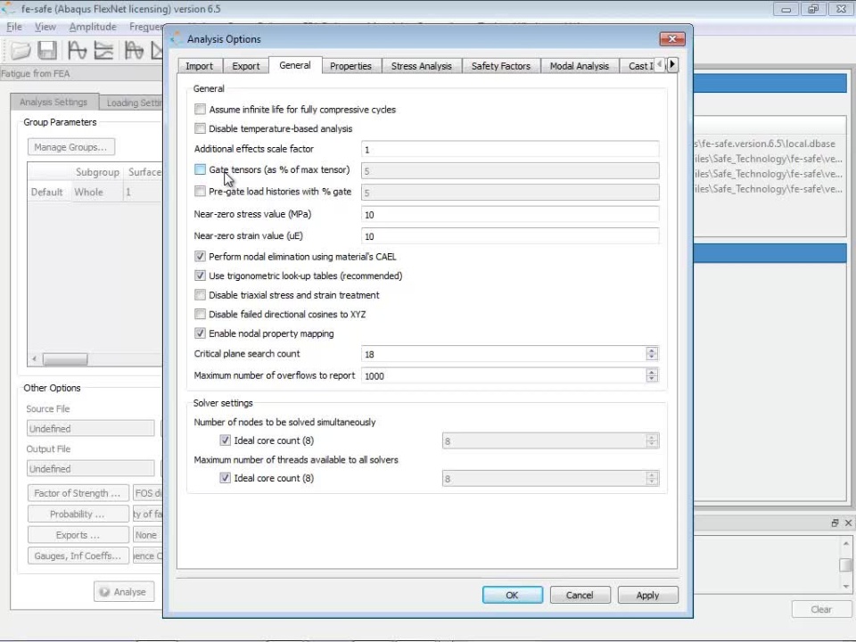

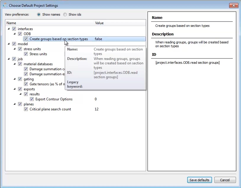

You might have a setting you like to use time and again in fe-safe. For instance: if your company sets a non-default gate level, or if you prefer to read groups as SECTION definitions instead of Element Sets from Abaqus ODB files. Any setting you can make in fe-safe is a user setting or a project setting and these can be made defaults after installation.
Narrated video
Below is a narrated video that explains how to configure the default settings for fe-safe..
