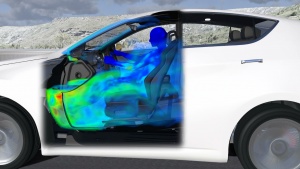

Using digital simulation in PowerFLOW coupled with PowerTHERM solutions for cabin comfort, engineers can design a cabin that ensures passengers will be comfortable when entering a vehicle and driving away in cold weather. Simulation re-creates real-world conditions, wherein a human in a comfortable environment gets into a vehicle that has been parked outdoors in cold weather for several hours. The time it takes to heat up the cabin and provide comfort to the human model(s) can then be accurately predicted, giving engineers the ability to determine if a design performs as expected in terms of comfort. Human body parts like back, thigh, and hands, which are in contact with the cold seat, experience severe discomfort and coldness initially after the human enters the vehicle. Using simulation to understand how much time it takes to attain a comfortable state for such uncomfortable parts, engineers can fine-tune the design, including the HVAC system controls, ensuring overall as well as local comfort for passengers while maintaining vehicle efficiency.
Simulating the impact of climate systems on humans – including thermal comfort, time to comfort, warmest (red, above) and coolest (blue) airflows, and heat transfer – is key to comfortable cabin designs.

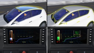

Energy management to preserve EV range is a high priority for OEMs. But waiting for physical testing to understand energy performance severely limits the design iterations that can be tested to meet these critical new consumer and regulatory targets. Identifying these critical design changes earlier in design and development – when the vehicle is still just a 3D model - reduces the number of costly iterations and rework that must be performed with physical prototypes, accelerating design and eliminating cost overruns for product development teams. Relying on physical testing alone limits new, energy-saving design innovations at just the time when they should be unleashed.
Time-to-comfort with non-insulated (left) and insulated (right) vehicle design options can be compared using PowerFLOW simulation, and the energy saved can be quantified in terms of added EV range.
New design solutions like different insulation options and different glass materials can easily be simulated and explored with PowerFLOW so engineers can introduce the right design solutions that help to better maintain passenger comfort while conserving energy. When less energy in the form of heat escapes the vehicle, passengers warm up more quickly and maintain comfort longer – so that the vehicle uses less energy, saving on battery power and adding to range.

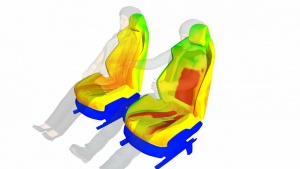

Using PowerFLOW solutions, active climate systems can be added to the digital cabin and designers can assess passenger comfort gained from these systems to design a cabin with the same level of comfort while relying less on the HVAC system to provide the energy needed to achieve that comfort. Placement and sizing of the active climate systems can then be optimized so that time-to-comfort targets are achieved with minimum energy consumption. In this way, PowerFLOW solutions offer a method to design cabins and HVAC systems that improve overall vehicle efficiency.
Using PowerFLOW, active climate systems (heated seat at right), can be compared with traditional solutions to quantify improvements in human comfort and introduce more efficient design solutions.
