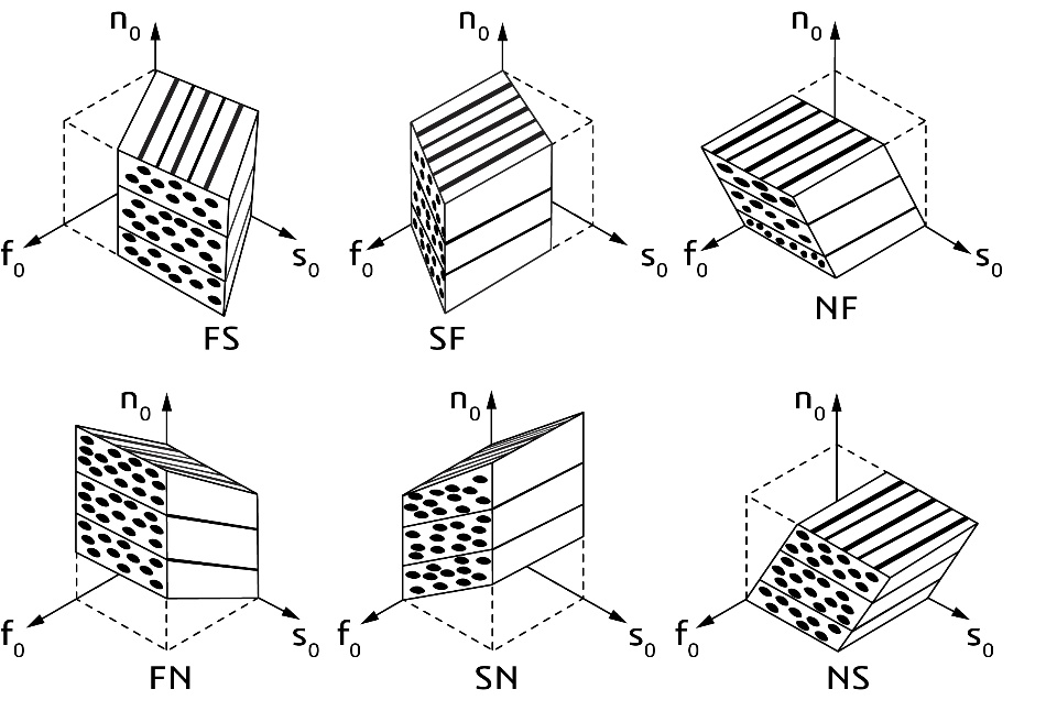

The image above shows a series of six triaxial shear tests performed on the myocardium tissue, as detailed in Sommer, et al, and other papers.  Sommer also shows biaxial testing which we will use here as well.

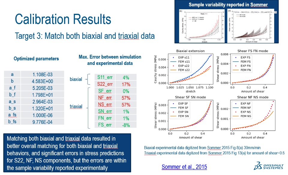

The work by Jiang Yao showed calibrations to just the equibiaxial test data, then just to the shear data, then a final calibration to all the test data. I have repeated all of that work using the calibration app, but for brevity will just show the final results here in this post.
Here is a slide showing the final calibration results from Jiang Yao and her team. Units on the "a" parameters are MPa.

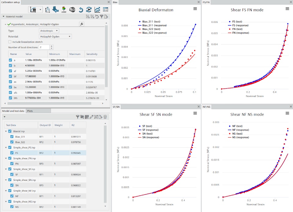

The image below comes from a development version of the calibration app that will be released in Feb, 2024.  This is not a calibration, but an "Evaluate" using the parameters determined by Yao and team (shown above). The resulting stress-strain curves (below) for the 8 responses match very well with the curves from Jiang Yao (above).  The aggregate R2 value for this solution is = 0.9402.
Because this material model was created with myocardium tissue in mind, the parameters shown above are used as the initialization parameters in the calibration app.
