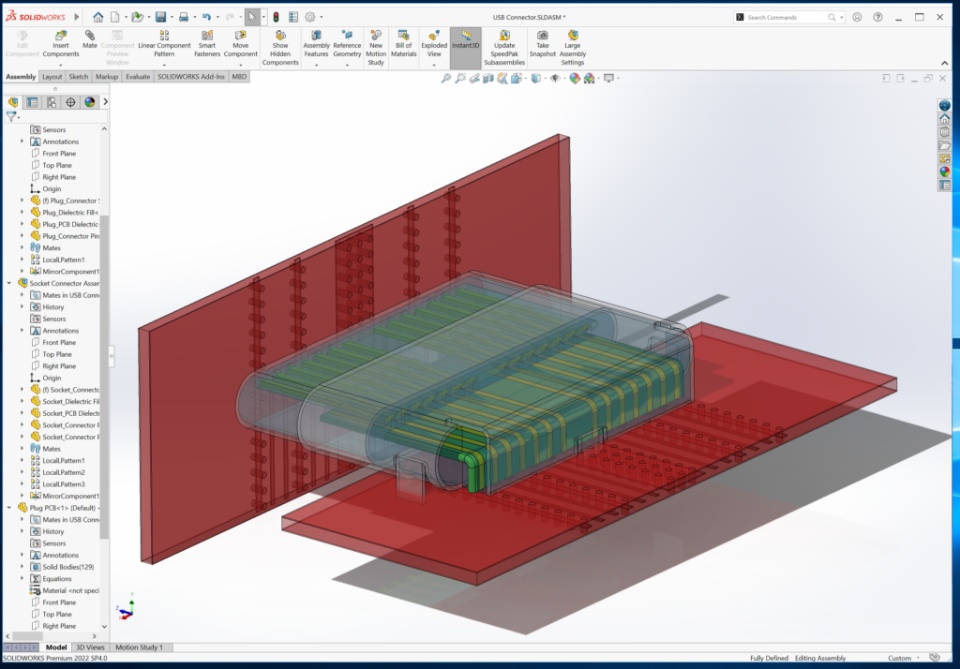

The design expert and the SI engineer, responsible for the simulation, will work together to assure the connector is meeting SI requirements. A parametric model is created using SOLIDWORKS connected and simulated on cloud.
Figure X shows the connector model designed in SOLIDWORKS. It consists of the male and female parts, each connected to their respective PCB. The model is parametric which simplifies the process of making changes to the geometry and design exploration. This model is saved to the 3DEXPERIENCE platform so that it can be accessed by all the stakeholders involved in the project.

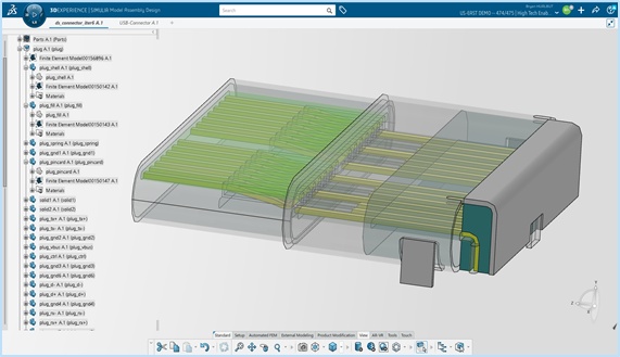

Now the SI engineer launches the electromagnetic simulation tool CST Studio Suite in Power’By mode and receives the updated model from the 3DEXPERIENCE platform. The model is saved locally with simulation settings, so important aspects such as frequency range, meshing, ports and excitation signals are defined, after which the simulation can be executed locally or on the 3DEXPERIENCE Cloud platform. The 3DEXPERIENCE Cloud platform brings the power of high-performance computing (HPC) to users with occasional demanding simulation needs, for whom dedicated on-site hardware would be too expensive. The cloud democratizes simulation, allowing designers to make better use of it and improve the MODSIM workflow.
A special electromagnetic solver is used called “Transient Transmission Line Matrix (TLM)”, which is well-suited to simulating interference/EMC on complex geometry. It uses the Perfect Boundary Approximation (cell warping) and cell lumping to significantly reduce the number of cells required to mesh the geometry, without jeopardizing the simulation’s accuracy. If necessary, the simulation can also include the cable itself and the geometry of the entire phone.
At the same time as the electromagnetic simulation, the mechanical performance of the connector can be simulated. Using the 3DEXPERIENCE platform, the connector model is opened in Abaqus, the structural simulation tool from SIMULIA. The insertion process is simulated using a “Virtual Twin” of the connector, outputting results such as strain on the pins (and resulting deformation), holding force and fatigue over many cycles.

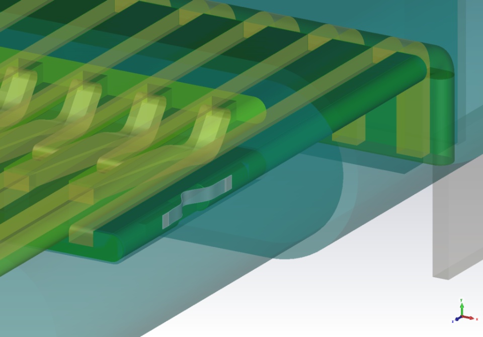

The signal integrity engineer identified that the baseline TDR showed too much of a dip in impedance at the spring location, and opted to reduce the length of socket pin stubs which may have been adding parasitic capacitance. This design change has to be communicated with the design expert. They will work together using Change Management to ensure the necessary changes to the connector model so that it meets the SI requirements and also complies with EMC standards, to be checked by the EMC engineer.
To request the change, the SI engineer uses Issue Management. The issue will be attached to the baseline geometry and will be visualized with a placemark. The designer is asked to modify the pin length of the socket in SOLIDWORKS. Once the value of the respective variables has been modified in SOLIDWORKS, the updated model will again be saved on the platform as a revision. The new design can be re-simulated – with both electromagnetic simulation and structural simulation – to ensure that it now meets the requirements and does not compromise mechanical performance. The simulations confirm that compliance with electromagnetic requirements does not adversely affect the electromagnetic performance of the connector.
