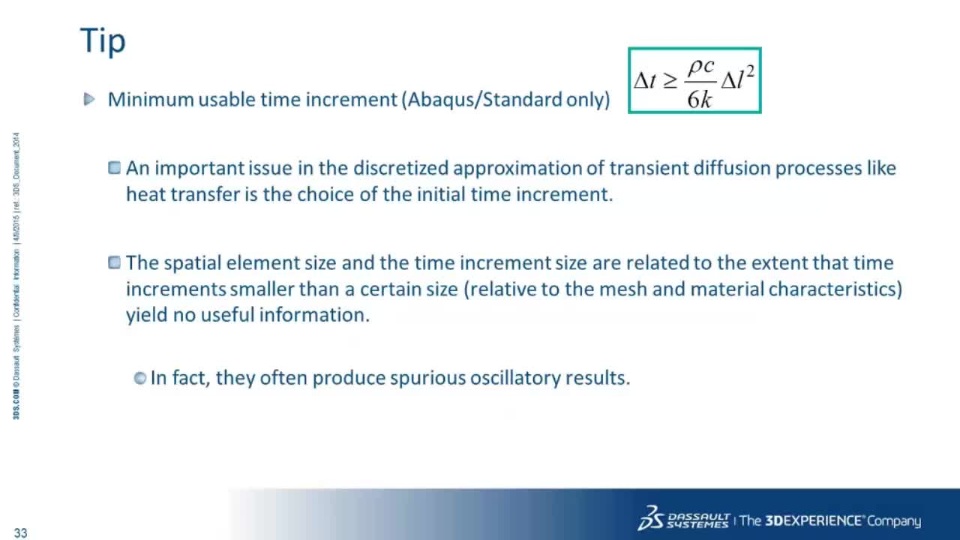

Q: Any guidelines on how to select the DELTMX parameter?
A: There are no specific guidelines on selecting the DELTMX parameter. IF you run the analysis and you see that there are a lot of changes happening between successive increments and feel that you are not able to capture the physics in fine enough detail then you can force Abaqus to take increment such that the temperature changes at all nodes in the model is less that the DELTMX parameter. If in doubt then I would recommend you leave it as the default.
