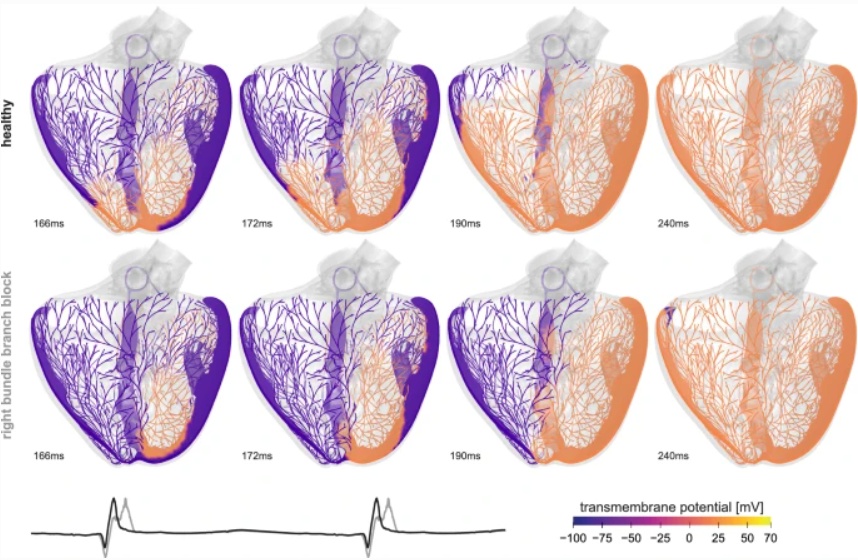

Electrophysiology—The healthy heart. Transmembrane potential across the left and right ventricles. Under physiological conditions, the Purkinje network excites the left and right ventricles simultaneously and induces synchronous ventricular contraction. Under pathological conditions of right bundle branch block, the left ventricle excites before the right ventricle and induces asynchronous contraction. The electrocardiogram highlights the differences between the physiological and pathological excitation pattern.

Using the Living Heart Model as a baseline geometry, the researchers created a Purkinje network for rapid cardiac excitation. They used Abaqus/Standard to simulate the heart through multiple cardiac cycles and triggered excitation by applying an external stimulus to the Purkinje network in the location of the atrioventricular node.
They then post-processed the results of the simulation to create a virtual echocardiogram, placing electrodes in the right and left arm and the left leg. The researchers also compared healthy and diseased activation patterns, side by side.
