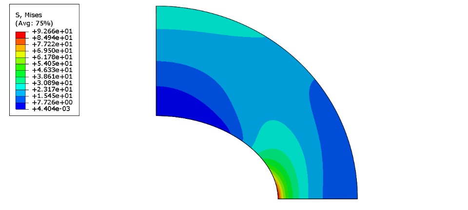

The problem description states that the reference solution is 92.7 MPa, easily verified by rebuilding the model geometrically in Abaqus/CAE and then using a "ridiculously" fine mesh (say, 0.002 mm edge length) of CPS8 elements. This results in 1.36 million elements, 8.19 million DOFs, and (mostly) a waste of 2.14e12 FLOPs (not FLOP/s, note the difference, one is a plural, the other a rate):

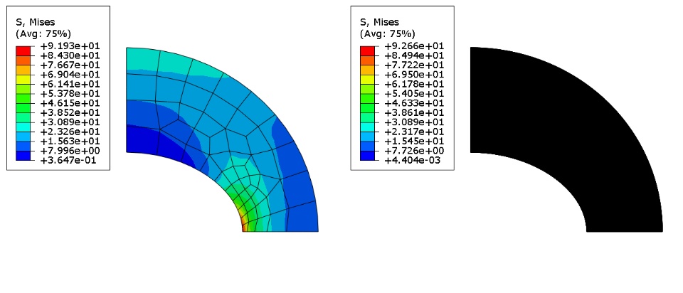

Now let us see with how few FLOPs we can get away if our target accuracy is to be within 1 per cent of the reference solution. Attention! Instead of the "anxiety mesh" (as I like to call a mesh that is way too fine because a clueless analyst was in fear of getting wrong results) we will now be using our brain and think about the problem. Remember little Gauss from my previous post?

To requote my finite element teacher here: "A model is the better, the more is known about the  result." Using this, we can capitalize on the previous section and now really exploit the fact that we  know that and where we will get high stresses: We will use a biased mesh with refinement towards  the point of stress concentration and a very large global mesh size. And, no surprise, with a mesh  size of 0.5 mm, biased to point D (see the documentation of this benchmark problem) with 0.08 mm  (as before), a mere 53 elements, 376 DOFs and a measly 4.00e5 FLOPs we get 91.9 MPa:
Summary
By using our brain we were able to land within 1 per cent of the reference solution, but with a numerical  effort smaller by a factor of 5 million compared to the "anxiety mesh" (which is so fine that with element edges shown the results are completely obscured, see above). The iPhone is "only" about 6000 times faster than the Cray. Wetware beats hardware. You first heard it here.
P.S.: Of course even with the "anxiety mesh" the model runs within minutes on a laptop. That is not my point. The immense savings are worth getting for larger problems, so think about your next overnight run.
