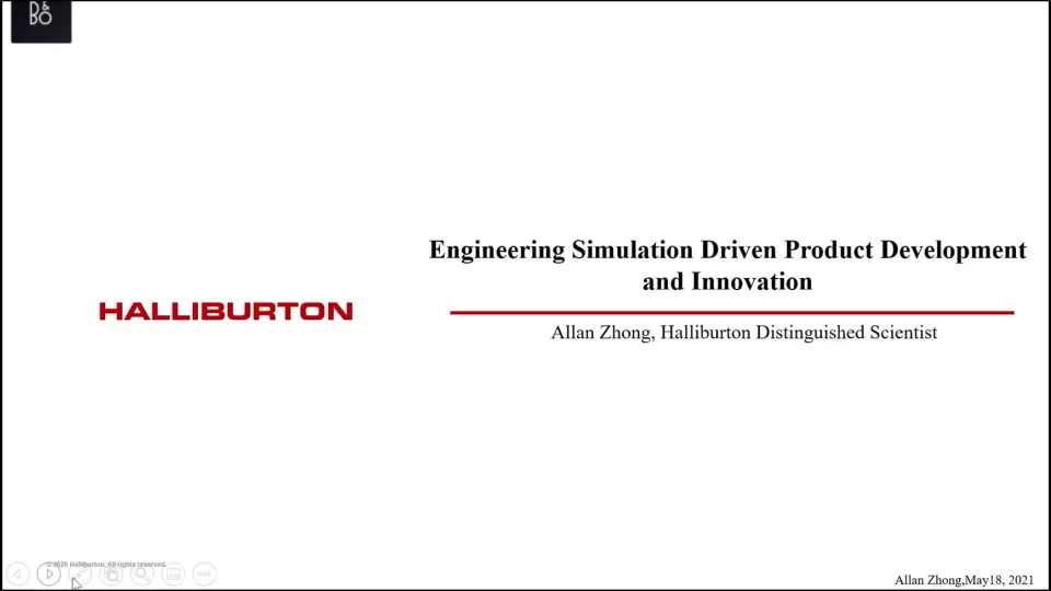

That was the topic of my plenary keynote presentation at the 2019 3DEXPERIENCE Modeling & Simulation Conference, Novi, MI, September 18-19, 2019, titled “On Formulations and Applications of Computational Modeling to Product Development”. I will extend my discussion on this topic at the 2021 North America Regional User Meeting on May 18, 2021, through my customer keynote presentation, “Engineering Simulation Driven Product Development and Innovation”.

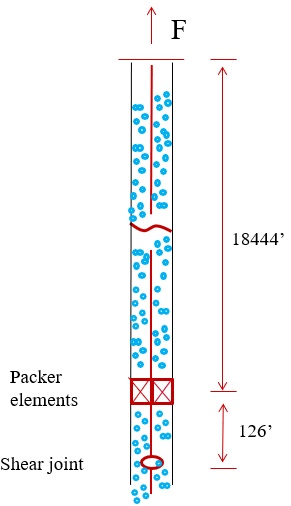

Here is one of the case studies discussed in the 2019 presentation for illustration on how to formulate a simple model for very complex engineering problems. This case study deals with the dynamics of a nearly 20,000-foot-long tool string in an oil well. Instead of a high-fidelity coupled fluid-structure interaction analysis, with proper idealization and approximations, we applied Abaqus Aqua ingeniously to solve this problem and provided insights and an operation envelop to our field engineers and customers. (see References for details: 1) Zhong, A., and Gano, J. (2008), Dynamic Response in a Pipe String during Drop-Catch in a Wellbore, 2008 ABAQUS USERS’ Conference, Newport, Rhode Island, May 19-22, 2008; 2) Zhong, A., and Felten, F. (2012), Dynamics of a Completion String in a Fluid Filled Wellbore, 2012 Simulia Community Conference, Providence, Rhode Island, May 15-17, 2012)
In the upcoming 2021 NAM RUM customer keynote presentation (May 18th, 1:35 pm) I will continue the discussion from 2019, with a focus on how to effectively apply engineering simulations to solve challenging engineering problems, drive innovation, and make a commercial impact.
