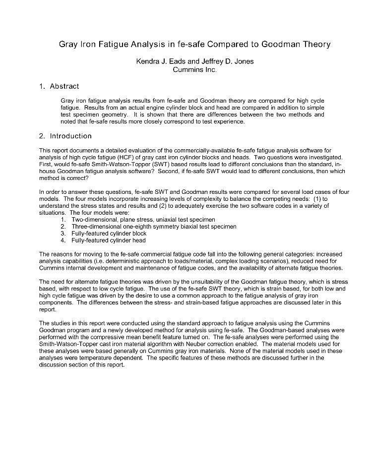

In the class we discuss three case studies as a Motivation for Fatigue. The paper gives the example of cylinder head fatigue and compares the traditional hand-calculation method of a Goodman Line with the S-N diagram approach (this can be done in fe-safe if required) with our default multiaxial strain-based fatigue algorithms in fe-safe. It should come as no surprise that the traditional method identified the wrong hotspot (a mistake that would have driven bad redesign if the users didn't have fe-safe).
One of the students asked for this paper, related to the first case study so I am sharing it here:
Gray Iron Fatigue Analysis in fe-safe Compared to Goodman Theory, Kendra J. Eads and Jeffrey D. Jones, Cummins Inc., fe-safe User Group Meeting 2006
The file is also attached:
