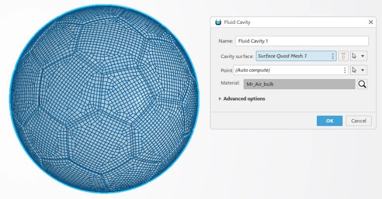

Filling up the football is done with a fluid cavity feature, which is just a fluid-filled structure to simulate its mechanical response. You define the fluid cavity to set the volume.
Here I used the mesh.
To set the fluid cavity there is a feature for that as a load so the inside of the ball have pressure.

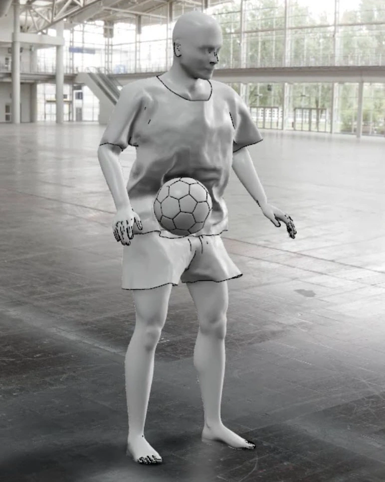

Then the impact simulation was made with the Abaqus/Explicit solver using a Dynamic Explicit scenario. The explicit solver takes small time steps depending on element size and does not wait for the solver to converge each time step. It is very effective/fast solver for dynamic events and includes time, energy, inertia and damping.
The football had an initial velocity. (Rotation can also be added).

Now, instead of testing an industrial equipment it was more fun to use a human model: (Bruce) + using the football.

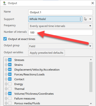

The goal of the simulation was to show an impact in slow motion. Using a lot of “output” frames – We can see a rapid event with a lot of details.
I want to see the result of 0.07s study with 100 frames.

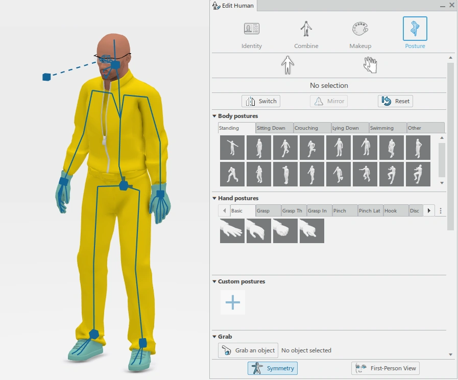

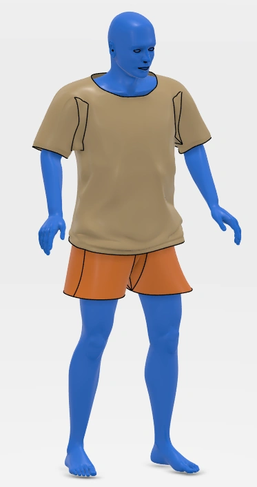

Bruce was done with the Human Experience Designer. It can create a lot of people with different outfits. There were no football characters so I needed to model the clothes by myself and defined them as surfaces/shell mesh. Bruce is a solid and some work was made to simplify the model since it came very detailed with teeth and eye lashes. (stuff not needed for the simulation)
