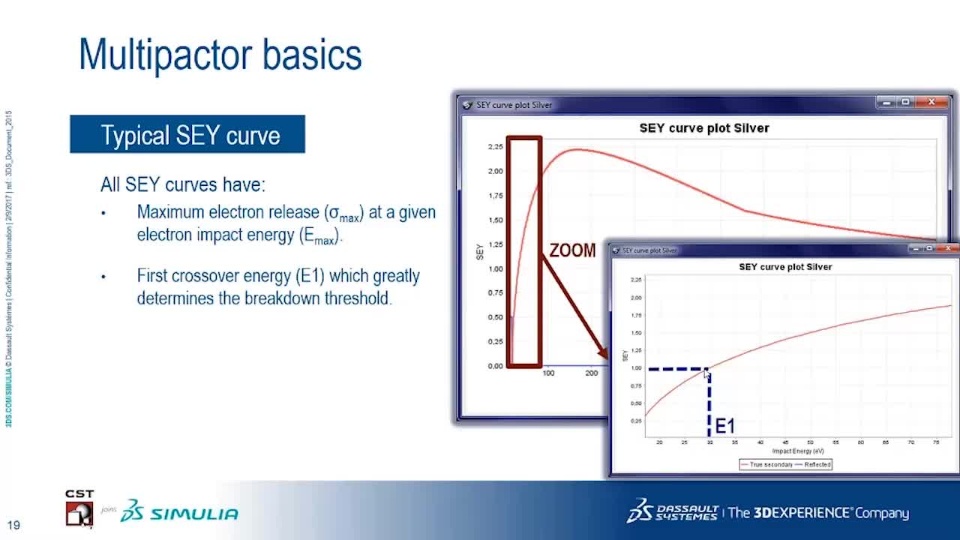

In this eSeminar we will review the RF Breakdown effects which can occur in space hardware namely multipactor discharge. Simulations with Spark3D​​​​​​​ and CST Studio Suite® will show the benefits of using a full numerical approach to tackle these problems in space applications
With this eSeminar, learn about:
  • The advantages of using full numerical approaches instead of analytical ones to determine the breakdown power level.
  • Situations in which analytical approaches are not valid.
  • Practical cases in which the analytical calculation significantly underestimates the breakdown power level.
