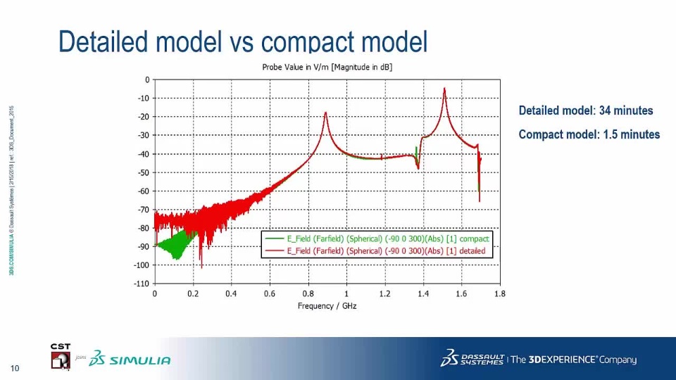

This eSeminar will explore how to use Compact Models in the CST Studio Suite Transmission-Line Matrix (TLM) solver to speed up the simulation of models with small features like slots, seams and vents, and composite materials like layered carbon fiber. These small features play a crucial role, especially in electromagnetic compatibility (EMC) simulation. Compact Models allow the simulation to run faster while maintaining the accuracy of the result, which provides an immense advantage over a fully detailed 3D model.
