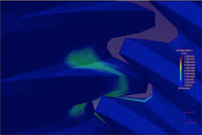

Gear stress was implemented using Catia gear assembly and then analyzed in SIMULIA. The test was done at max power plus an additional 20% factor of safety. In this analysis the entire gear was able to be tested including the shaft connection points as opposed to the face and tooth stress analysis done above. These results showed that all gears were within allowable stress tolerances designated by AMGA.

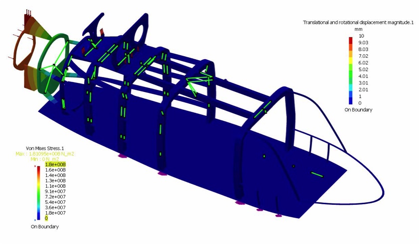

As the design phase gets to the final iteration, a finite element model is developed in Abaqus for Catia to verify if the structure is going to be able to perform certain maneuvers and satisfy the requirements from 14 CFR – Part 29 (subpart c). The finite element model should be able to withstand any critical condition with the proper factor of safety, which is define as the yield of the material over the maximum stress. A factor of safety of 1.5 is set as a constraint to optimize the structure. Based on the accuracy from first assumptions constructing the CATIA model, the number of iterations would vary from results of the FEM. However, since the CATIA model is parametric, this updates are perform almost instantly. Static loads are applied in different areas as seen in the figure , the main loads are applied from the hub and blades, transmission, engines and rear propfan since they will influence the primary structure. Loads applied were 18,512N for the hub and blades, 7,879N for the transmission, 3,332N for both engines and 3,400N for the rear propfan.
