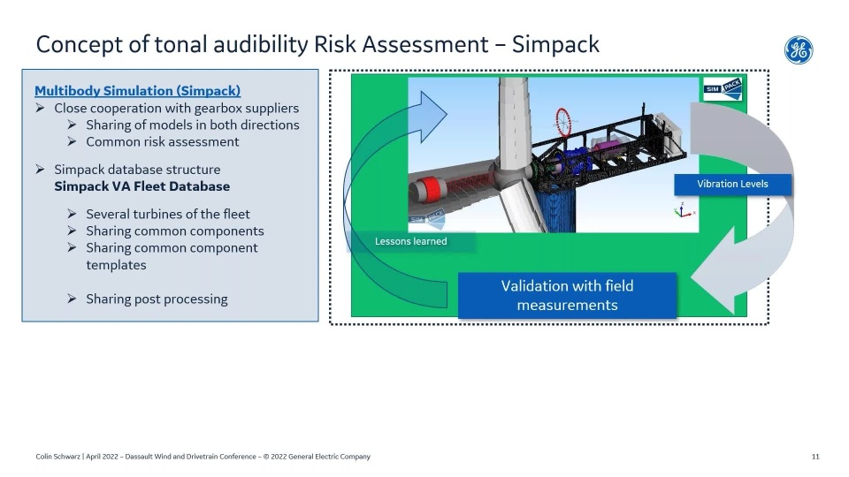

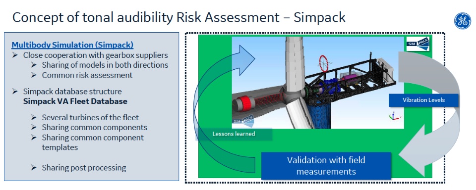

The noise emission of wind turbines and farms can be an important and limiting factor for the acceptance and thus further growth of wind energy. Next to the overall noise emission level, tonal noise from machinery and drivetrain components can be disturbing contributions.
This presentation discusses the modeling of tonal noise contributions originated by gearbox teeth meshing, transmitted through complex, structure-borne transfer paths into the machine head, and radiated by tower and blade surfaces. A seamless tool-chain of multibody simulation and boundary element method to solve the wave equation is a core feature to integrate such an approach for risk assessment and analysis into established design processes. Its reliability and uncertainty need to be understood very well to drive design decisions early in the design phases.
