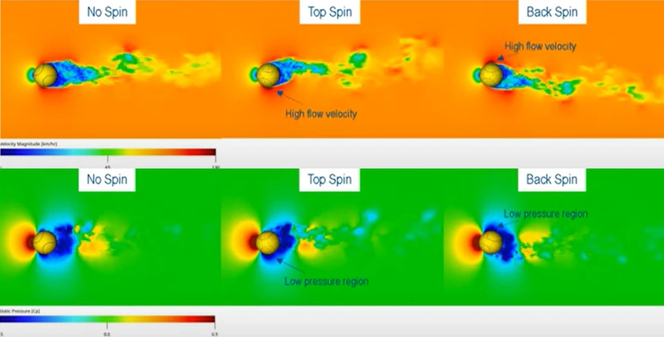

In tennis, to minimize unforced errors, players try to get some margin above the net and use top spin to help the ball to fall back inside the lines of the court. Due to the rotation of the ball, the air below the ball is accelerated while the air above the ball is slowed down, resulting in a pressure gradient (Bernoulli’s equation) and an upward shift of the wake from earlier flow separation at the top of the ball, which creates a downward force that will work along gravity to keep the ball inside the court.
When keeping the ball low, the net becomes more of an obstacle and it can become challenging to keep the ball deep to neutralize the opponent. Players then use the opposite effect (high pressure below the ball and low pressure above the ball) with backspin, which will create an upward force that will keep the ball flight longer and give the “floating” behavior to the ball to get some depth to the shot despite playing close to the net.

SIMULIA Fluids solutions allow us to simulate such a phenomenon to better visualize the effect of the rotation of the ball on the fluids and, subsequently, how the aerodynamics forces will impact the trajectory of the ball.
A rotating sphere modeling a tennis ball is being analyzed. Here, we use headwind (i.e. no angle of the incoming flow vs the ball motion), but that is something that could be studied through a Design Of Experiment.

The simulation is trying to get us information regarding how the rotation of the ball affects the airflow around the ball and how the aerodynamic forces will impact the trajectory of the ball.

Simulation allows us to see the flow and directly get an understanding of the impact of the ball rotation on the flow. We can see the separation/wake shifting and the pressure changing around the ball. Simulation gives us an accurate way to compute the aerodynamics forces on the ball and how these change with rotation (top spin, back spin etc.) that tennis players would use. Such changes will affect the trajectory of the ball and one could imagine a manufacturer to use such an approach to change the mechanical characteristics of their product.
