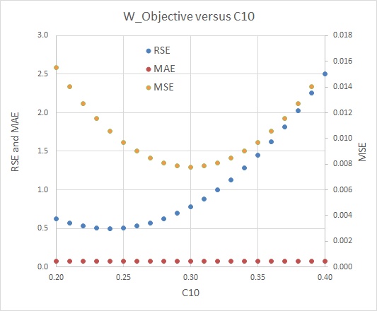

In row 32, the weighted objective is formed for all of the error norms in MAS (weights=1 in this work).  This Excel file is set up to allow the use of the Excel solver.
In row 34 and below, values are gathered to show how the weighted objective varies as a function of C10. The image below is taken from the Excel file. The purpose of this graph is to show that the "optimal" solution will depend on the choice of error norm. For RSE, the optimal solution is C10=0.24, for MSE, the optimal solution is C10=0.30   For MAE, this is quite interesting, there is no unique solution to the problem. For all values of C10 between 0.20 and 0.40, the MAE error norm has the same value. An optimizing solver may determine an answer that is initial value dependent.
