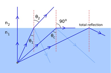

From high school physics we know that light refracts passing from one medium to another. The incident and refracted angles can be found using famous Snell–Descartes law.  According to Snell–Descartes law, there would be an angle, known as critical angle, in which the refracted light can no longer enter the second medium. It is called total internal reflection.
 [Source of picture: Wikipedia: Behavior of a ray incident from a medium of higher refractive index n1 to a medium of lower refractive index n2 ,  at increasing angles of incidence]

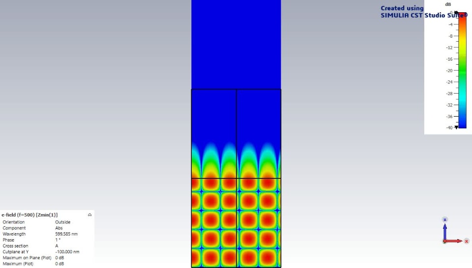

𝛳=20 (smaller than critical angle)
If incidence angle < critical angle, the wave enters in the second medium. This has been shown by visualizing the electric field.

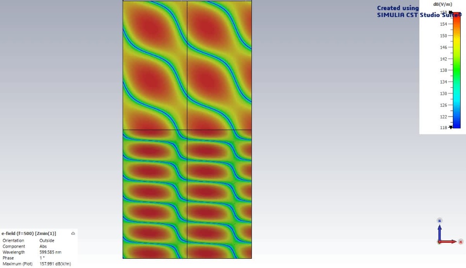

𝛳=45 (greater than critical angle)
We see that in case of total internal reflection no field could enter in second medium and the energy will all be kept inside the first medium.

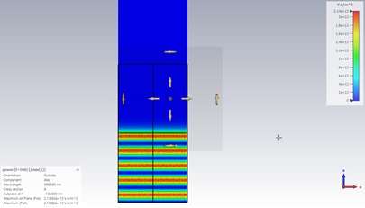

Electric field
                                                                       Power Flow

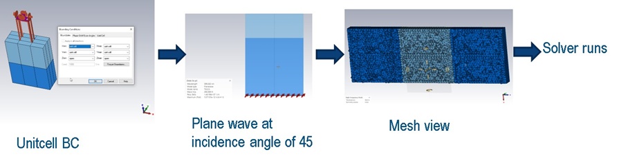

How is it implemented in CST Studio Suite?
Unitcell Boundary Condition (available in Frequency solver) enables the user with two dimensional infinite array in x and y directions in combination with Floquet ports in Zmin and Zmax directions. The desired incidence angle of the Flouqet modes can be set by user. The first two modes are the fundamental plane waves created in the direction of incidence angles.
Images below show a short summary of this procedure.
