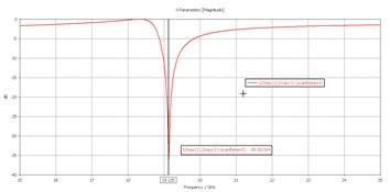

In below, a rather simple but effective approach for FSS based radome is discussed. A hexagon lattice based unit cell is designed and later simulated in CST Studio Suite. As the reflection coefficient of the unit cell suggest, there is a frequency, namely at 19.12GHz, in which the fields can mainly go through the periodic structure while at other frequency there would be a relatively huge reflection. Well it is safe to say that we have a kind of band pass filter.

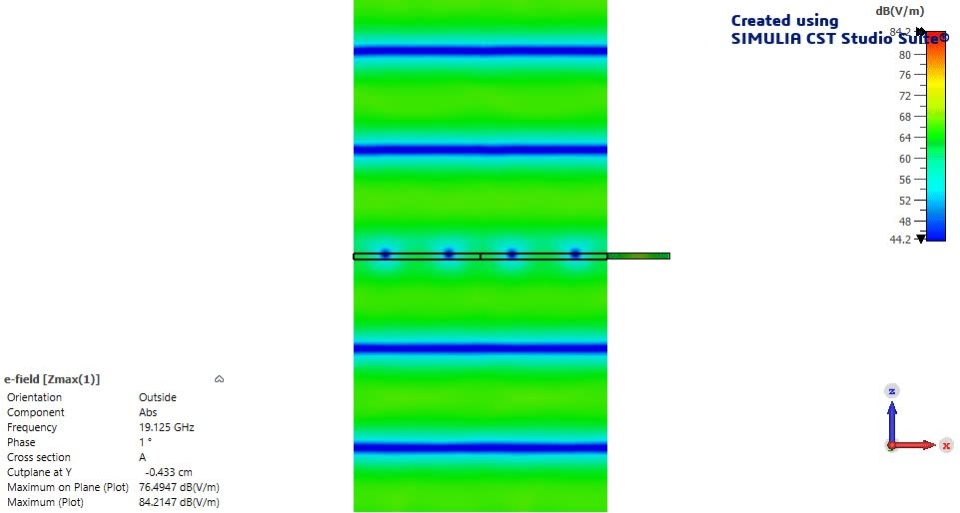

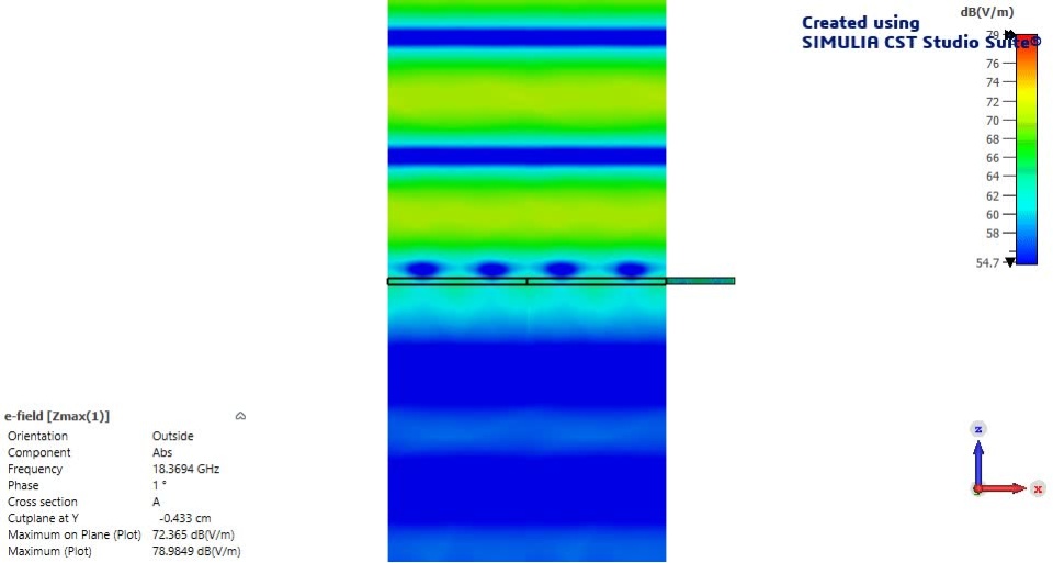

The field visualizations at the two frequencies, one at pass band and other at notch band would consolidate the concept clearer.
field visualization at notch band frequency
field visualization at pass band frequency

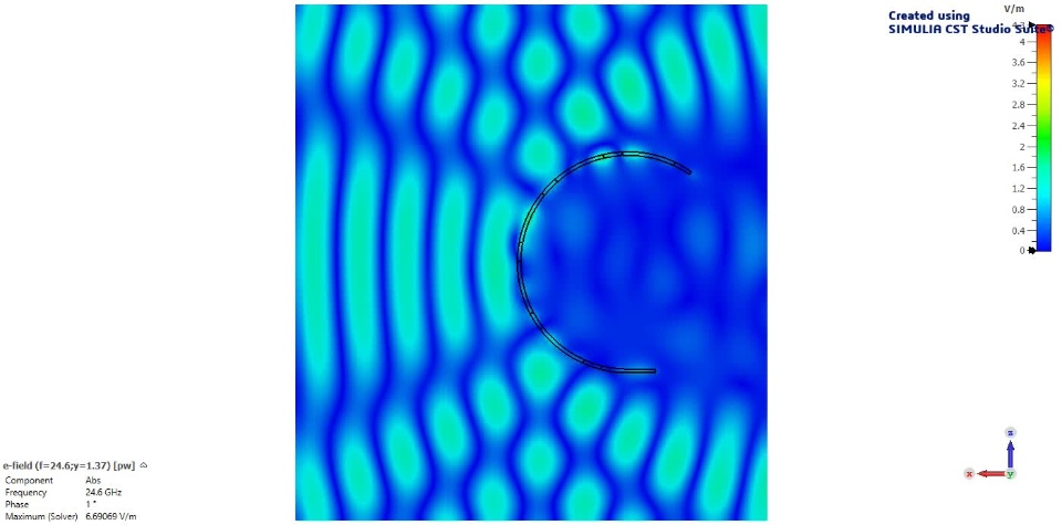

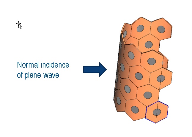

To show a proof of concept, a half cylindrically bended FSS based radome has been investigated under a normal incidence of plane wave. The radome is supposed to damp the incoming frequencies except the pass band frequency or 19.12GHz.
The full wave simulation considering the finite size FSS and plane wave were conducted by Time domain solver.

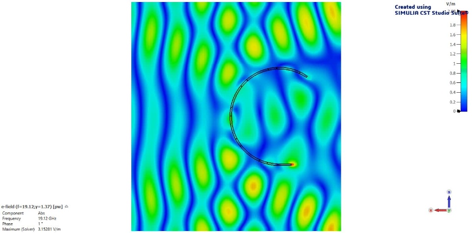

As the animated field results indicate, the field penetration in two the domain protected by radome is visibly reduced due to the radome FSS effect.
field visualization for finite structure for a notch band frequency
field visualization for finite structure for the passband frequency
