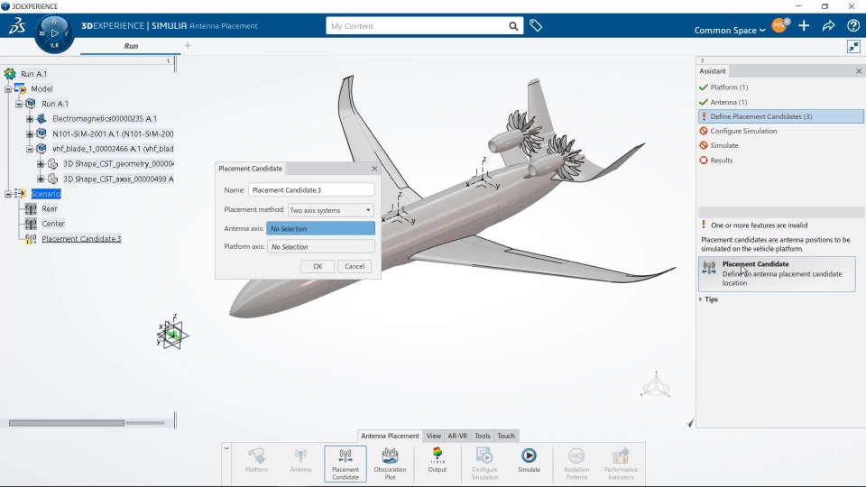

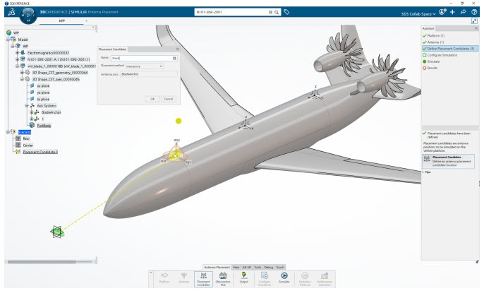

The first task, therefore, is to identify a few candidate locations. In some cases, there may also be multiple antenna designs to compare as well or a radome around the antenna. The CATIA model of the aircraft and the simulation models of the antennas are opened in the SIMULIA Antenna Placement app. If the antenna model is not available from the manufacturer, a simulation model can be produced with the Antenna Magus tool. The app opens a simulation project with a master template, with appropriate solver and mesh settings already set up. The user marks antenna locations on the model with an intuitive 3D interface, and a first quick simulation shows how the antenna is obstructed in each location.

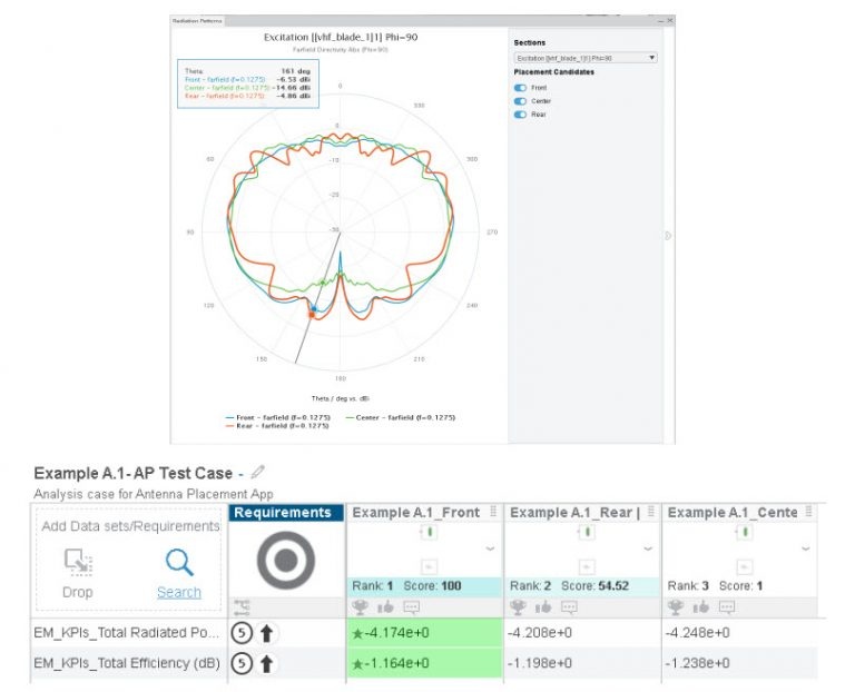

The results of this simulation include all the key performance indicators (KPIs) such as total radiated power (TRP), efficiency, directivity, gain, and axial ratio, as well as the far-field radiation pattern in graphical format. The different antenna placements can be easily compared in the Performance Trade-Off table to find the best configuration for the application, and the candidates are automatically ranked. Different far-field cuts can be checked to ensure there are no obstructions or excessive side lobes. When there are multiple antennas on a platform, co-site interference between them can also be analyzed to identify and mitigate potential issues, leveraging the best-in-class SIMULIA CST Studio Suite.
