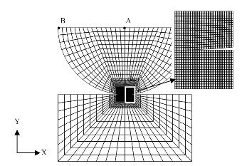

This model uses Abaqus to solve the contact and elasticity problem for a cylinder and a flat (a classical Hertzian contact) during a single fretting cycle.  The normal pressure and slip at the contact were then used to calculate the change in surface height using Archard’s equation.  The modified surface profile is then used to update the old finite element mesh to match the worn surface.  The stress during the next cycle was then calculated using Abaqus and the process is repeated.
To save computational time, the wear rate was assumed to be constant over the span of a number of cycles.  This allows a the simulation to be completed in a reasonable amount of time and does not significantly change the results.  It also avoids problems with significant figures when trying to update the location of nodes by very small amounts.  There is, however, a critical cycle increment above which the model becomes unstable.
