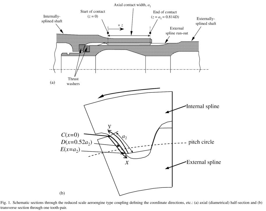

One reason for using three dimensional analysis is that many “real world” components and interactions are too complex to be closely approximated in two dimensions. One such application is the spline-coupling which appears in the gas turbines used to power airplanes. These couplings experience varying torques, axial loads, and bending moments during each flight. A schematic of the coupling is shown in the following figure. Expand the image for a better view.

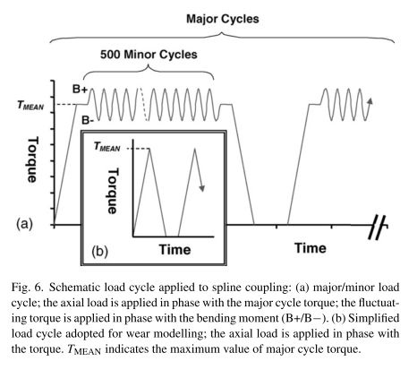

A great deal of complexity has been included in modeling the spline coupling. For example see the loading cycle which was matched to the operational conditions. Here a major cycle was considered to be a flight while minor fluctuations were the change in loading during a flight.
