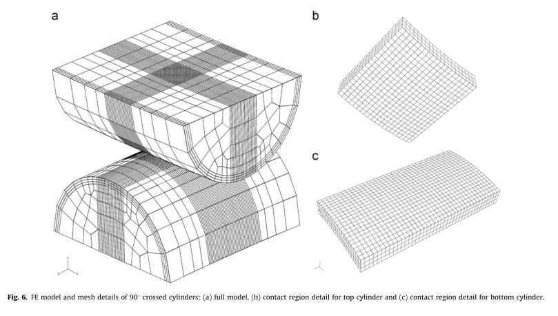

A partitional meshing strategy was used for the two cylinders and its results can be seen in the picture below.  The cubic shape of the elements is better for uniform numerical analysis than the tetrahedral elements.  Three-dimensional eight node linear brick element were used in the study.  Partitional meshing is a relatively simple way of having a highly organized mesh and refining it along in three dimensions although it is different from the strategies which I have seen used in two dimensional studies.

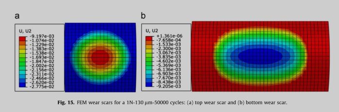

For the crossed cylinder geometry it was important to model wear on both surfaces not only the upper or lower body.  However, the contact was solved using a master-slave algorithm.  This makes it difficult to determine the pressure and slip on the master surface.  The pressures and slips need to be interpolated onto the opposing surface.  Cruzado et al. tried three strategies for interpolating between the surfaces:
  • Bivariate interpolation
  • Triangle-based linear interpolation
  • Nearest interpolation

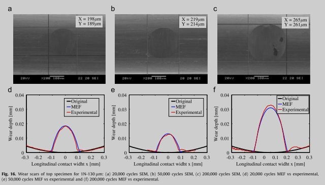

The effect of mesh size was investigated.  Mesh refinement was not found to have a large effect on the surface dimensions of the wear scar, but it did affect the wear depth.  A coarse mesh led to a trapezoidal profile for the wear scar.  The authors decided that the optimal size was 3% to 4% of the final wear scar width.
The authors also studied the number of steps needed to carry out each cycle and found that a specific value was optimal.  The value in and of itself is not critical because it will probably vary with different simulation loadings and geometries.  If fewer than the critical number of increments was used convergence problems appeared.  The cycle jump or number of real life cycles each computational fretting cycle represented was also found to be extremely important.  The authors gave their solutions which would be a good starting point for anyone carrying out similar studies.
