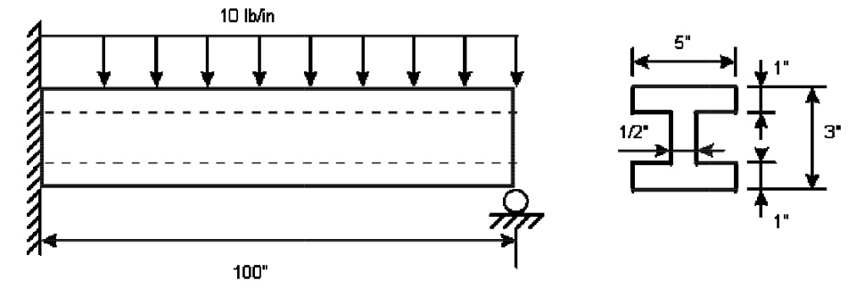

This tutorial shows how to build and analyze a propped cantilever beam. The finite element model of the beam will be constructed using Abaqus/CAE. Three different loads are considered:
Material: |
Steel |
Load case 1: |
Distributed |
Load case 2: |
Lumped |
Load case 3: |
Consistent |
