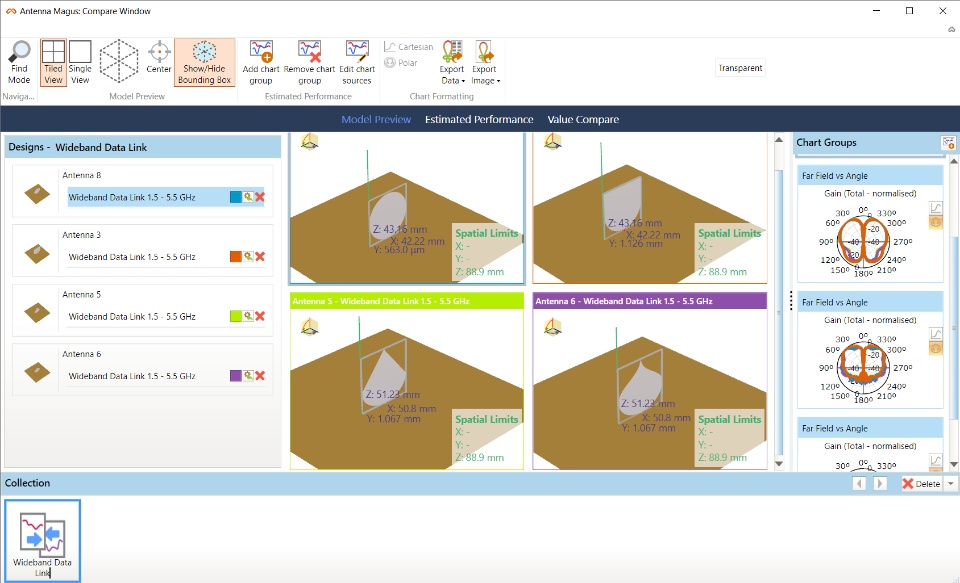

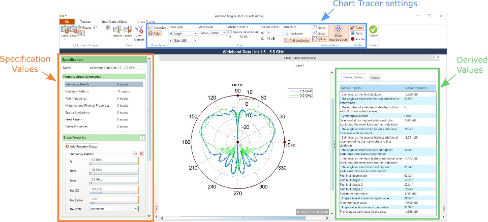

This can be done in a few simple stages. First, the user inputs the data as a specification in Antenna Magus. Radiation pattern cuts can be scanned in and traced to automatically calculate KPI’s such as gain and beamwidth. Additional keywords such as “blade”, “monopole” or “wire” can also be used to narrow down the search.
Figure 2: Comparing different antenna candidates in Antenna Magus

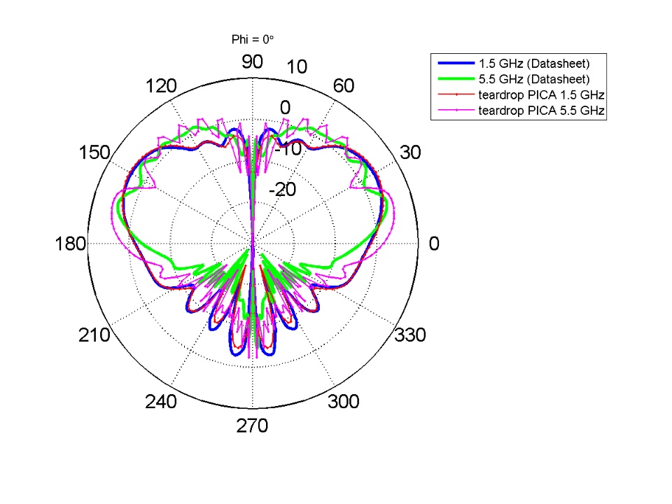

Antenna Magus then searches its extensive library of antenna designs and suggests types of antennas that could have the properties specified by the user (Figure 2). The user can choose the most suitable of these and export the models into SIMULIA CST Studio Suite for detailed 3D modeling and simulation. The automatically generated models can be adjusted as needed (for example, radomes added or ground planes changed) and simulated to verify the antenna still performs according to the datasheet (Figure 3). This verified model can then be used for a detailed full system simulation in SIMULIA CST Studio Suite or using the Antenna Placement App on the 3DEXPERIENCE platform.
Figure 3: Simulated teardrop PICA and datasheet patterns at φ = 0°
