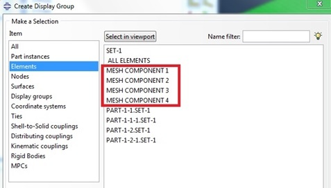

An output database file (.odb) will be generated, and element sets will be created by grouping each of the unconnected regions. These element sets can be viewed using the display group feature in the visualization module of Abaqus/CAE or Viewer. The various unconnected regions will show up as MESH_COMPONENT 1, MESH_COMPONENT 2 e.t.c.

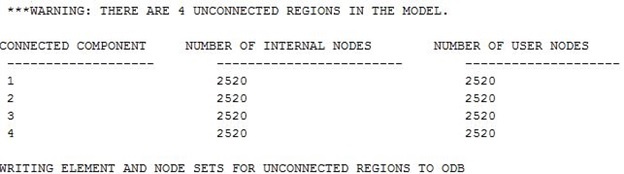

A message (as shown below) will also get printed in the message (.msg) file showing how many nodes each of these unconnected regions have.
