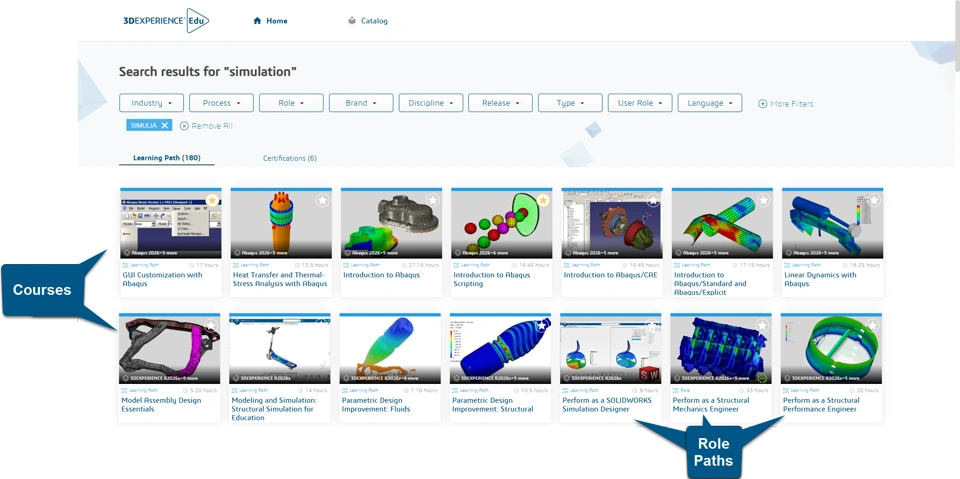

New: Courses are now called Learning Paths
All of your learnings are now gathered under the Learning Path tab, including:
- Courses which used to be called Learning Modules, such as Introduction to Abaqus or Structural Simulation Essentials (for 3DEXPERIENCE users).
- Role paths: each one of these starts with Perform and links to a list of courses appropriate for a 3DEXPEREINCE role such as Perform as an All Physics Analyst. The courses in this role based learning path give you options to learn about the apps enabled with the role.

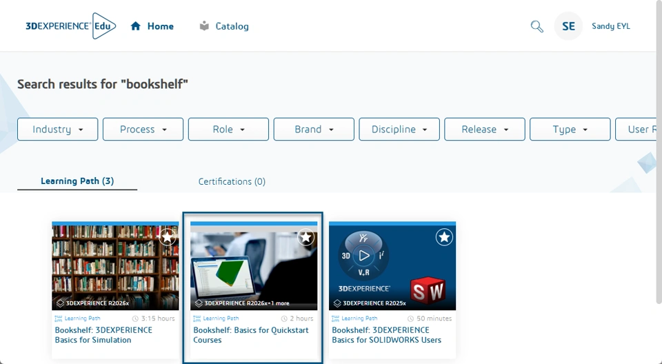

Search for a course

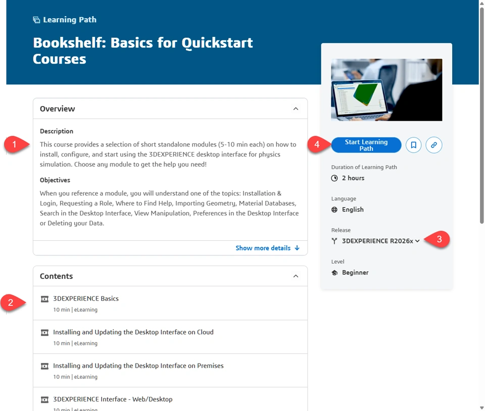

Once you're in the 3DEXPERIENCE Edu Space, use the search icon to search a word or phrase. e.g. search for bookshelf. A Bookshelf is the name of our optional prerequisite for 3DEXPERIENCE. Unless you're currently completing a Quickstart or Primer course, the Bookshelf you want to play is Bookshelf: 3DEXPERIENCE Basics for Simulation. If you haven't used the 3DEXPERIENCE platform before, you can find answers in the bookshelf, whenever you need help with beginner questions.
The course overview will be shown
- Review the Description
- Notice the Contents showing titles for each module in the bookshelf. To view any of these you need to start the course.
- Before starting the course, use the drop-down to make sure you're using the correct Release (usually you want the latest)
- Click Start Learning Path (this may take a few seconds)

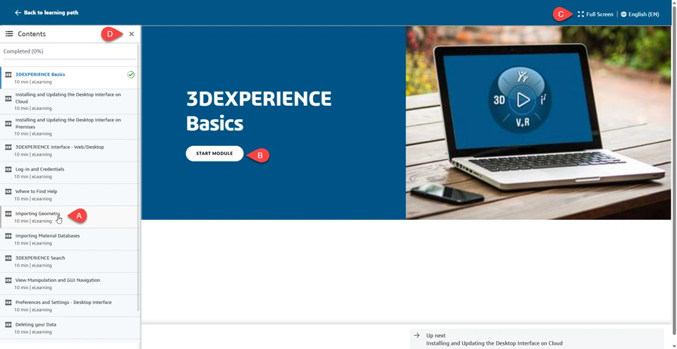

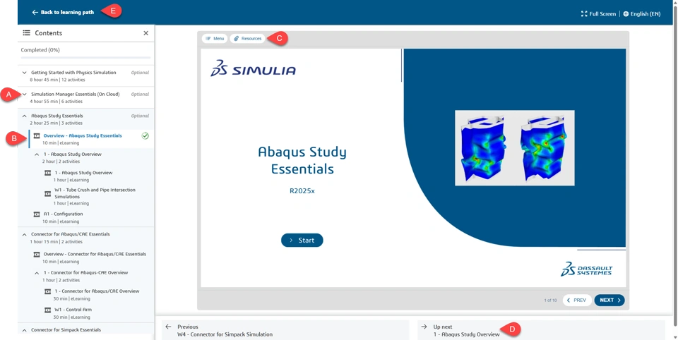

In the player, you can:
- Navigate to any module using the Contents.
- Click Start Module to play your selected module.
- Click Full Screen to expand the contents in your browser
- Click X if you need to hide the Contents.

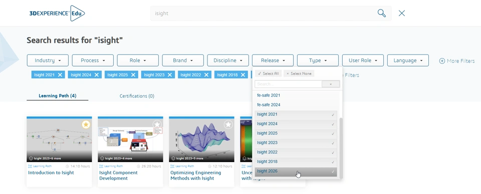

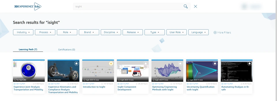

You need a voucher or subscription access to Learning Experiences for SIMULIA Products to see on-demand training for the SIMULIA standalone applications & traditional products. Search for a simple term (e.g. Isight shown here) to find familiar course titles on Abaqus, fe-safe, Isight, Tosca, Simpack, PowerFLOW, XFlow, Opera, and/or CST Studio Suite (depending on your libraries):
In the image above, note that there are some non-Isight courses (Experience* or *fe-safe courses shown). If needed you can use the Release filter to select your Release of Isight:

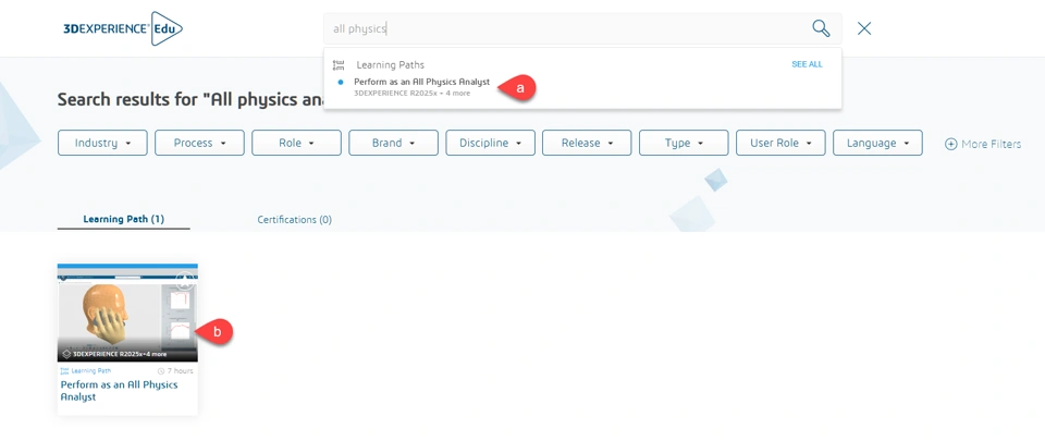

Are you looking for training on the 3DEXPERIENCE platform? For instance All Physics Analyst allows you to run jobs from Abaqus and other SIMULIA products, using the 3DEXPERIENCE cloud. Perform as an All Physics Analyst is the role path containing all of the courses available for your role. Search on Edu Space for all physics to find this path. You can click the course title either in the:
- Quick Suggestions shown while typing the search term
- Learning Path tab after entering the search term

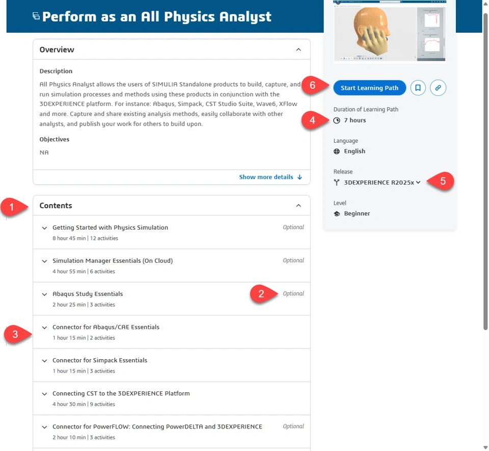

The learning path overview will be shown
- Notice the Contents showing the courses in this path.
- Courses may be labeled Optional (these are optional prerequisites or advanced contents).
- The course(s) that are not labeled optional are Recommended learning for this role.
- The Duration of the role path is the sum of the durations of the recommended courses.
- Before starting the path, use the drop-down to make sure you're using the correct Release (usually you want the latest)
