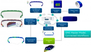

Fig.1: Integrated tire workflows with one master model

  • This solution is based on the common master model in which the same unified model is used for all the tire workflows shown in Fig. 1.
  • This end-to-end solution is available in the form of process templates in which the simulation loads and boundary conditions are predefined. This ensures that the user does not need to worry about setting up the model again and again, and instead just needs to select the 2D cross section of the tire to be analyzed. The process template will automatically mesh the cross-section and perform the simulation. Once a process is captured, experts can deploy templates of the process within their organizations for consumption by more non-expert users. With the process templates, it is possible to outsource simulation at the designer level.
  • Workflows are integrated with each other using Process Composer, as shown in Fig. 2 – i.e., the output from one workflow becomes the required input to the next workflow in the design process. For example, a steady state thermal analysis takes heat flux as an input from a rolling resistance workflow where the actual heat dissipation is simulated, similarly the surface film coefficients are taken from an aerodynamic drag analysis. The 2D model creation for the steady state heat transfer workflow uses the same master model used to build the 2D axisymmetric model for the structural workflow.
