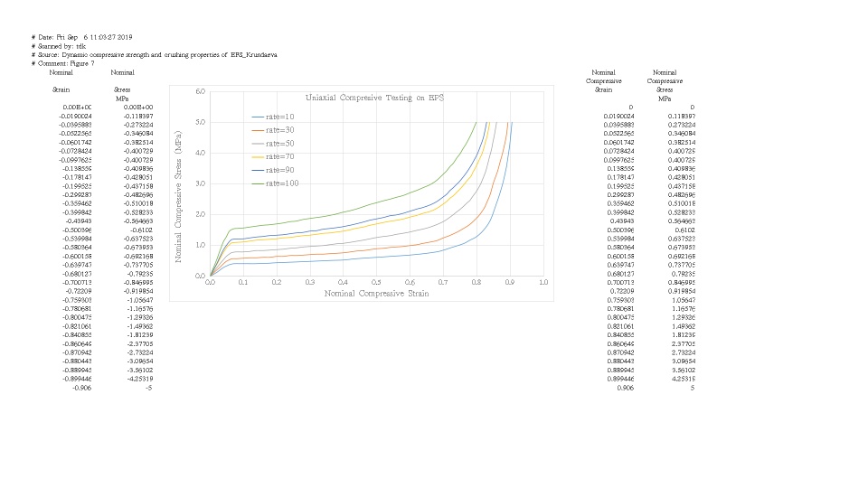

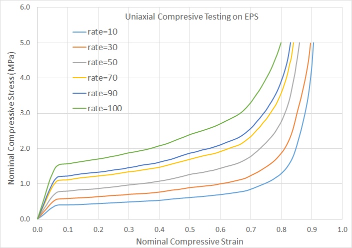

This paper by Krundaeva, et al, contains some nice test data for an expanded polystyrene crushable foam (EPS).  EPS material has been commonly used in bicycle helmets.  In particular, I have scanned the test data from Figure 7 of the paper and attach it to this post in an Excel file.
