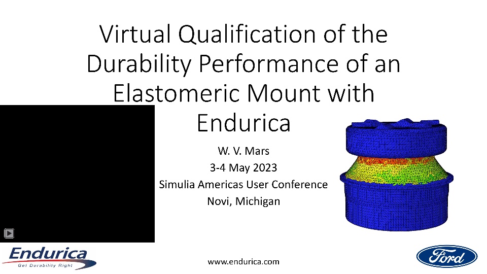

Abstract: An elastomeric mount sees complex loads in service, and engineers must show that the mount can endure those loads. This presentation shows how the entire qualification procedure used by Ford for an elastomeric motor mount can be simulated in Abaqus and post-processed with Endurica. The loading schedule is composed of 144 different events recorded at the test track, each having as many as 6 input channels (3 forces and 3 moments). The analysis begins by computing a nonlinear map of finite element model stress-strain fields to a series of sampling points in the global load input space. This map is then used in Endurica EIE to rapidly generate full transient stress-strain history (15.6 million time steps!) for each finite element. This process produces 3.2 TB of stress-strain history, which is then passed to Endurica CL to solve for fatigue life. The analysis takes into account the elastomer’s nonlinear material properties, and correctly predicts failure location and fatigue life. The entire process was executed in 90 hours of compute time.
