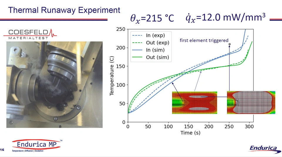

Coupled workflows for steady-state temperature and stress-strain fields in elastomeric structures are well established. However, many elastomeric structures exhibit transient response due to time-varying loading, or other factors.  Some elastomeric structures are designed to operate in a transient environment, so the steady-state analysis is neither accurate nor useful. This work presents some recent developments for transient thermomechanical analysis, including viscoelastic self-heating and a new exothermic reaction capability to simulate chemical breakdown due to high operating temperatures. A developing workflow is presented to simulate the diffusion of air through an elastomeric structure, together with the reaction of oxygen, to understand the impact of oxidative aging.
Co-simulation with ABAQUS and Endurica is used to accomplish these coupled analyses.  A new Endurica product, Endurica MP, is introduced to provide the “Multi-Physics” capabilities required for these advanced workflows.  Demonstration of the workflows is provided through the analysis of tires and other elastomeric structures.
