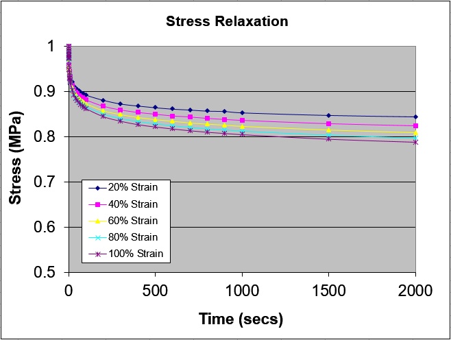

This is test data used in the SIMULIA course "Testing and Analysis of Elastomers" taught at the Axel Products test facility. www.axelproducts.com
This test data would be used to calibrate a hyperelastic+Prony series material model. The data includes a short time (instantaneous) uniaxial test, plus a series of stress relaxation tests over a range of strain loadings. This type of test data is valuable for understanding whether linear viscoelasticity is applicable, or whether one should model the behavior with nonlinear viscoelasticity - PRF model.
