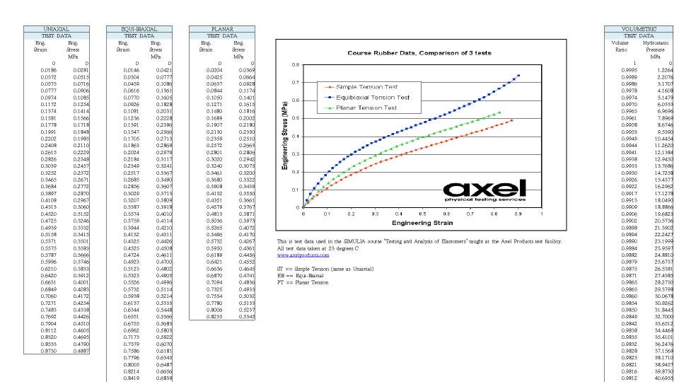

This is test data used in the SIMULIA course "Testing and Analysis of Elastomers" taught at the Axel Products test facility.   www.axelproducts.com

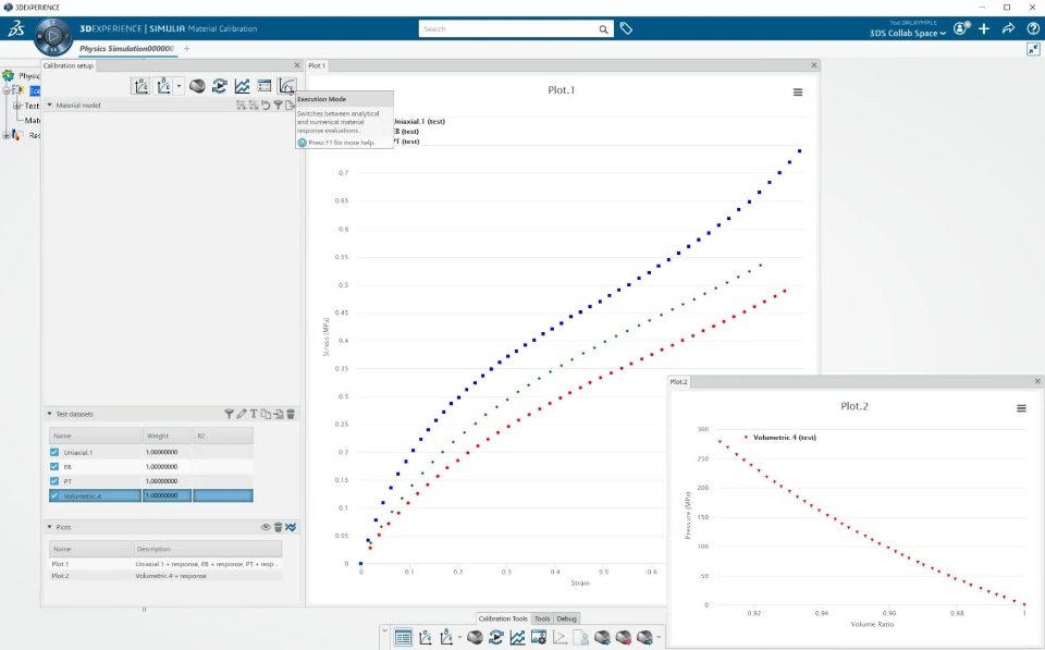

This test data would be used to calibrate simple hyperelastic material models. The data includes volumetric test data measured by way of a confined compression test (equivalent to a volumetric or hydrostatic test for materials with high bulk modulus).
Below is a short (5 min) video of using this test data in a simple calibration.  The video was made on May 4, 2020 using the development version of the calibration app. It has a similar look & feel as 2020x FD02, aka FP2014.  Sorry if it seems a bit rushed, but I was trying to cover a lot of material in just 5 minutes.
