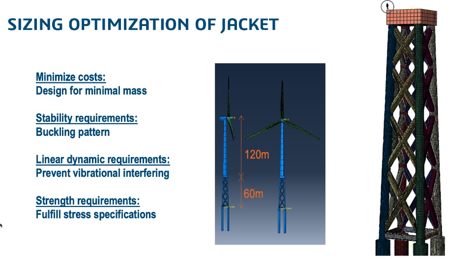

The present work addresses the challenging topic of methodical obtaining new conceptual designs for structural wind turbine components and improving the existing structural designs of wind turbines.

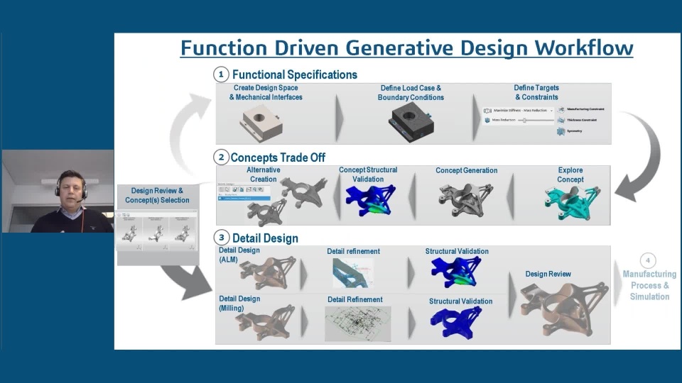

Typically, topology optimization is applied in the early design phase, where the optimization targets minimize mass considering stiffness, strength, and manufacturing requirements. Topology optimization provides the ability to make early decisions in the mechanical design cycles and reduce costs.
Sheet thickness sizing of non-linear optimization is applied to maximize buckling and post-buckling loading capacity and at the same time minimize mass subject to strength and linear modal eigenfrequency requirements.
For shape optimization, the CAE mesh is adapted where the objective is to minimize the stress or minimize the damage and thereby maximize the safety factors.
Lastly, we address one of the main obstacles in embedding non-parametric optimization methods in the product design process: the lack of efficient CAD- reconstruction methods. To the author’s knowledge, this is the first dedicated workbench for CAD-reconstructed of non-parametric optimization results. Additionally, the process is integrated into the 3DEXPERIENCE platform allowing a complete associated design workflow.
