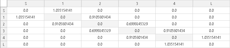

Using these specifications in FD3D, we obtain a coupling matrix for this response as shown in Fig. 1. We shall use this coupling matrix as target during the complete design procedure.
Fig. 1: Coupling matrix for the SIW filter.

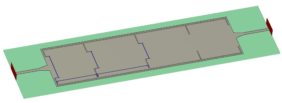

We have selected the following basic elements to build the SIW filter shown in Fig 2:
  1. Resonators: rectangular resonators in which the electric walls are implemented by means of via-holes.
  2. Internal couplings: rectangular irises in which the electric walls are implemented with via- holes.
  3. External couplings: tapered microstrip-to-SIW transition.
Fig. 2: 3D model of the SIW filter.
We have obtained the initial dimensions of each component through quick Eigenmode simulations. Then, we have assigned a design parameter per component (indicated by the dimension lines (blue) in Fig. 2) to control the individual mechanisms associated with the coupling matrix:

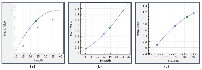

In Fig. 3, we show the variation of each coupling matrix element within the range defined for the physical design parameter.
Fig. 3: (a) Coupling matrix value of the resonator component as a function of the cavity length. (b) Coupling matrix value of the inter-resonator couplings as a function of the iris width. (c) Coupling matrix value of the source/load as a function of the iris width at the microstrip-to-SIW transition.

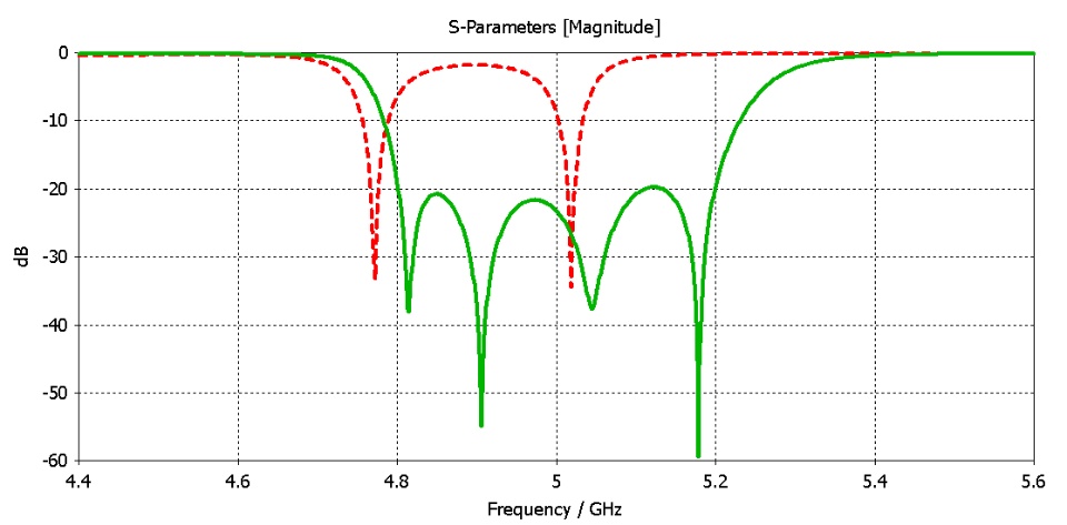

For the initial design, FD3D selects the appropriate dimensions according to these curves for the individual coupling matrix entries. The initial response (indicated by the red dashed curve in Fig. 4) deviates from the target due to loading effects not considered in the eigenmode analysis. To solve this, we launch the space mapping ad-hoc optimization included in FD3D. This algorithm extracts the coupling matrix from the S-parameters and calculates a new set of parameter values based on the curves in Fig. 3. The result of this ad-hoc procedure is shown by the green solid curve in Fig. 4, where the desired filter response of the synthesis is achieved.
Fig. 4: Reflection coefficient of the filter. The red dashed curve is the response after the initial design procedure. The green solid curve is the final response of the filter once the ad-hoc space mapping optimization algorithm is applied.

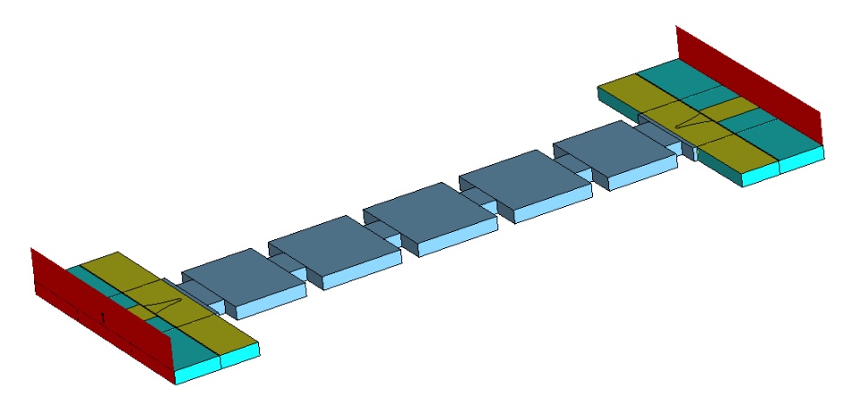

  4. Connect the two parts (transition + waveguide filter) in CST Studio Suite Circuits & Systems and execute the optimizer based on the extraction of the coupling matrix, where the FD3D project in step 1 is selected as the goal.
Fig. 5: 3D model of the ESIW filter.

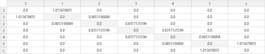

Using these specifications in FD3D, we obtain the corresponding coupling matrix as shown in Fig. 6.
Fig. 6: Coupling matrix of the ESIW filter.

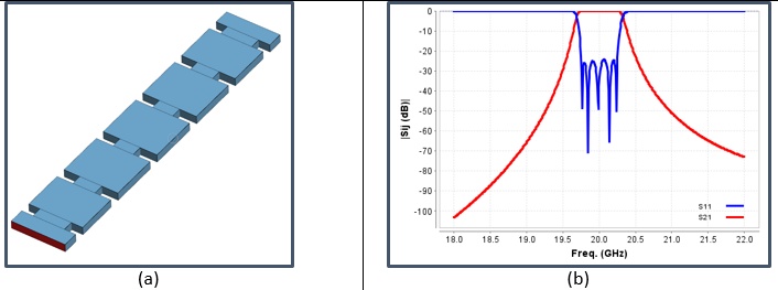

We have designed the waveguide filter using the Fest3D automatic design tool for inductive bandpass filters. We have selected as port the standard rectangular waveguide WR-42. However, the key of the ESIW filter design is to simplify the connection of the filter to the transition by using the same filter height as the thickness of the substrate of the transition (see Fig. 5). In this case, we have chosen a substrate with a thickness of 1.524 mm [2], which is then the height of the filter as shown in Fig. 7 (a). Using the automatic design tool, we have obtained the response in Fig. 7(b), which perfectly meets the specifications. Note that this is obtained without the need for additional optimization.
Fig 7: Waveguide filter designed with the automatic design tool in Fest3D.

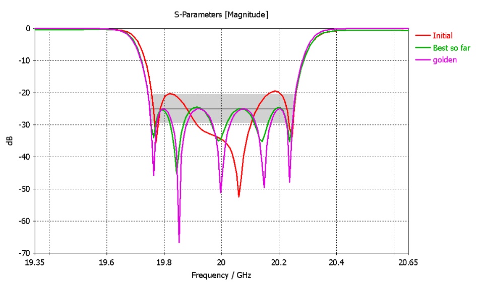

The next step is to connect the waveguide filter to the input/output transition. To do so, we have used CST Studio Suite Circuits & Systems, which is able to connect electromagnetically both parts by means of the EM modes at the interfaces. We then obtain the result shown by the red curve in Fig. 9. The result is already quite close to the golden (ideal) response because we have designed the transition to have a very good matching and, as already said, the interface of the transition and the filter have the same dimensions (no mismatch is added). Finally, we optimize the component using CST Studio Suite® optimizer coupled to FD3D, i.e., instead of using the S-parameters as goal function for the optimizer, we use the ideal coupling matrix (See Fig. 6). In addition, to do this final optimization we only need to tune the waveguide filter, not the transition. Therefore, the optimization process is very efficient because we compute the waveguide filter with the Fest3D EM modal solver, and the transition block is not recomputed from iteration to iteration. The final response has an ideal equal ripple as seen from the green curve in Fig. 9.
Fig. 9: Response of the complete filter before (Initial) and after (Best so far) optimization.
