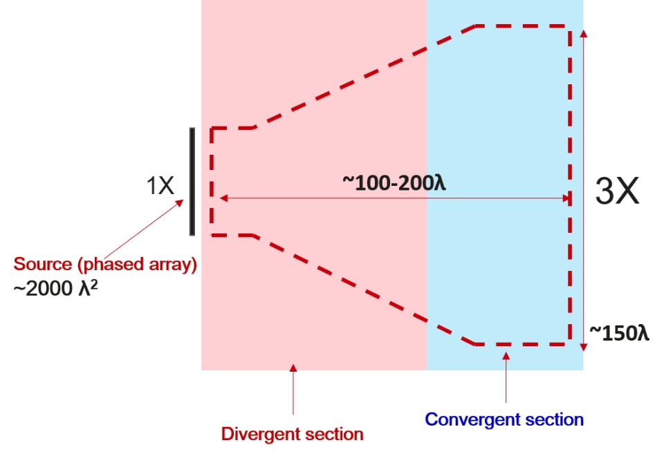

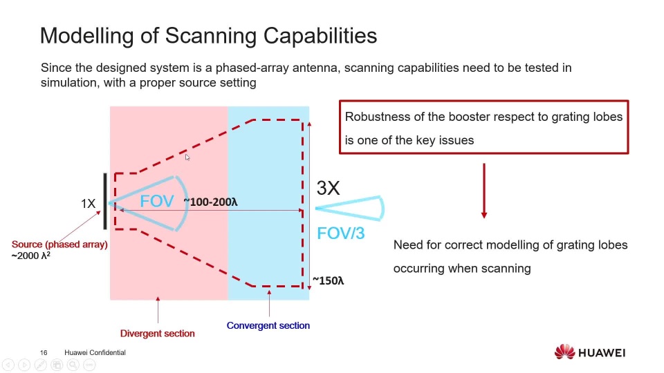

My presentation on the EuroMed SIMULIA Regional User Meeting 2021 illustrates the simulation techniques used to effectively design a lens booster at D-band frequencies with CST Microwave Studio; particular actions have been taken in order to limit the complexity of the model, and to simulate a structure that has very large dimensions respect to the wavelength. Different modelling and solving methodologies have been discussed and compared.
