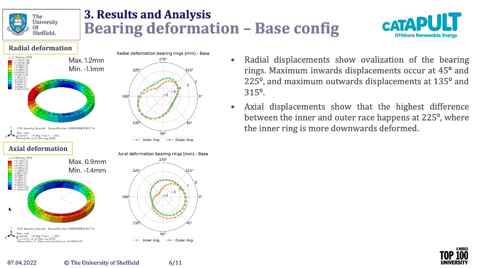

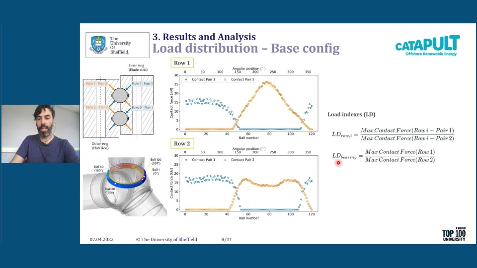

Pitch bearing connects the blades to the hub, allowing the rotation of the blades to control the loads and power in wind turbines. These bearings are affected by different damage modes such as edge loading, core crushing, rotational wear, false Brinelling, and fretting corrosion. One of the relevant factors related to these damage modes is the load distribution among the rolling elements.
Uneven load distribution is a common feature of pitch bearings, as they are mounted on highly flexible structures (hub and blades). The effect of the bearing’s supporting structures on the load distribution has been largely studied; yet little evidence exists on the impact that modifying the flexibility of these components has on the bearing load distribution.
This work presents a load distribution analysis for a 2-meter diameter ball bearing using a finite element model of the assembly between the bearings, the blades, and the hub. Different assembly stiffness configurations are defined and compared by defining indexes to quantify the uniformity of the load distribution. It is concluded that increasing the radial stiffness of the hub produces the best results to effectively improve the load distribution among the rolling elements, resulting in the maximum contact load reduced by 20% for the studied bearing.
