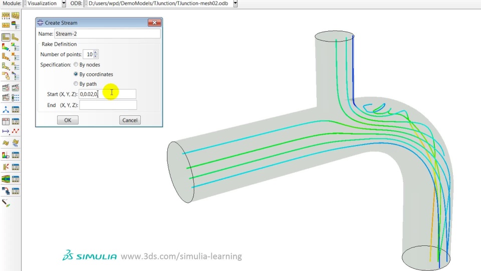

A streamline traces the path tangent to a nodal vector field, and a stream is a set of streamlines that enable you to visualize data emanating from a particular location in a vector field.
Streamlines are most commonly used to display velocity data in a fluid flow analysis.  In this case, streamlines show the direction the fluid will travel in at any point in time. The curvature of a streamline is related to the pressure gradient acting perpendicular to the streamline.  Streamlines can serve as a useful tool in engineering design process; for example, they are used in design studies aimed at reducing drag on structures.
Narrated Video
The following video includes:
   - An introduction (0-0:50)
   - A demonstration of creating streamlines (0:50-8:30)
         -- 0:50-2:15    Create Streams overview
                              Basic workflow:
         -- 2:15-2:45   1) Create Stream using By nodes specification method
         -- 2:45-3:15    2) Activate translucency to view the streamlines
         -- 3:15-3:40    3) Use the Stream Manager to customize streams
                              Advanced usage:
         -- 3:40-5:00   Create Stream using By coordinates specification method
         -- 5:00-6:25   Create Stream using By path specification method
         -- 6:25-7:35   Advanced streamline customization
         -- 7:35-8:30   Controlling the output variable used to color streamlines
