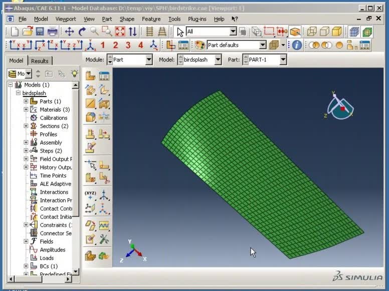

Download the attached file: SPH-BirdStrike-Model-Abaqus611.zip
Extract its contents, and run ws_sph_birdstrike.py before starting the steps shown in the demo.   If you get stuck, you can run ws_sph_birdstrike-demoAnswer.py to complete the Abaqus/CAE model as shown in the demo, and/or run completed input file birdstrike-final.inp.
Written instructions are provided in SPH-BirdStrike-StepByStep-Abaqus611.pdf (included in SPH-BirdStrike-Model-Abaqus611.zip)
