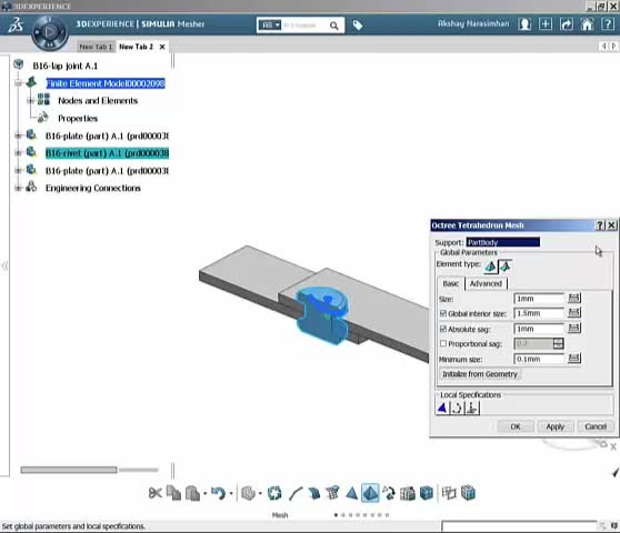

Narrated Video
Below is a narrated video that shows how to create a FE Model in the 3DEXPERIENCE Platform and mesh the assembly using tools available in the Mesher.
