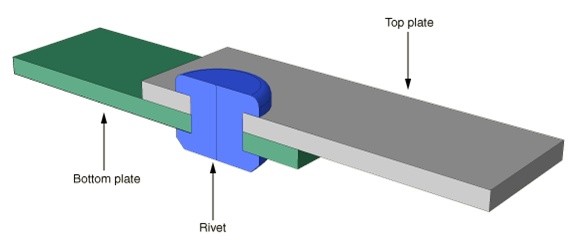

This series of tutorials will teach you how to set up a simulation using the Physics apps in the 3DEXPERIENCE Platform. We will be considering an example of a lap joint assembly to demonstrate different features in the Physics apps.
Problem Statement
This is a simulation of the shearing of a lap joint. The model consists of two overlapping aluminum plates that are connected with a titanium rivet. The left end of the bottom plate is fixed, and the force is applied to the right end of the top plate to shear the joint. Because of symmetry, only half of the joint is modeled to reduce computational cost. Frictional contact is assumed.

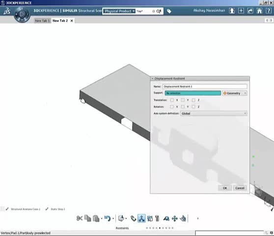

  • Navigate between different apps to create an FEA model.
  • Create a simple simulation and submit it for analysis.
  • View the analysis results.
