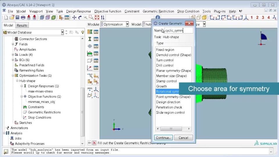

  7. Create geometric restrictions
    • Rotational symmetry with axis in direction (1,0,0),
      apply to DESIGN_NODES,
      120 degree repeating pattern
    • Node fixations in all 3 static directions for node group FIX
