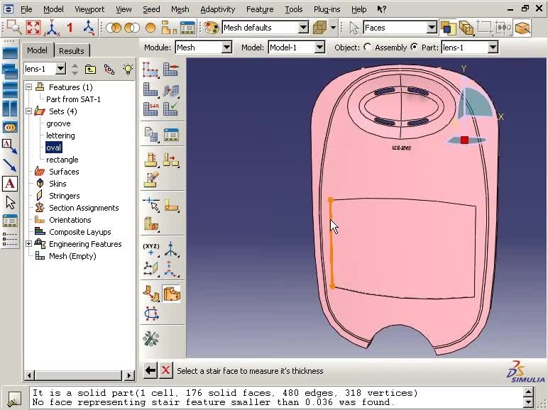

The video below shows an example of using the automatic virtual topology tool to remove stair-like features.

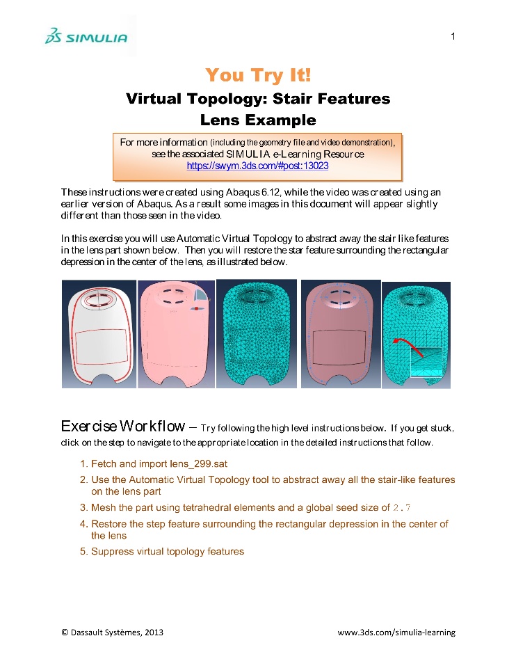

Click the icon below to download the attached file, VirtualTopologyStairFeatures-Lens-StepbyStep-Abaqus612.pdf.  Follow the included step-by-step instructions to practice using virtual topology to smoothly mesh over stair-like geometry.
This exercise was produced using Abaqus 6.12.

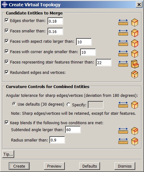

The automatic virtual topology tool allows you to do more than smooth over stair-like features.  Using the same workflow demonstrated above, you can also abstract away:
- Short edges
- Small faces
- Narrow faces with a large aspect ratio
- Faces with small corner angles
- Redundant edges and vertices
