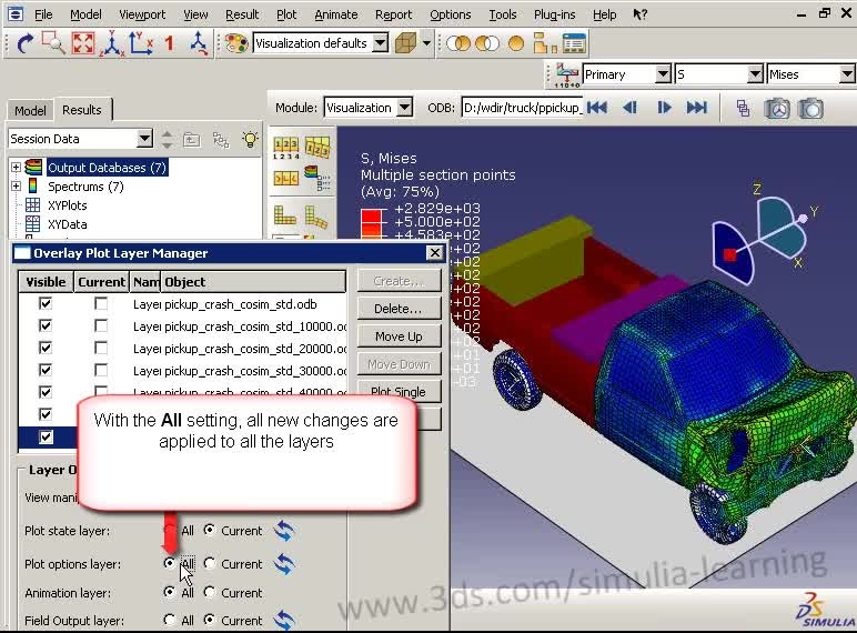

The Automatic Overlay Plot and the Combine ODB Plug-in can both be used to quickly and easily view multiple result files at the same time.
Situations where you may have multiple output database (.odb) files that you may want to view together in an Automatic Overlay Plot or a single Combined ODB include:

- Automatic Overlay Plot demonstration (0:13-3:21)
