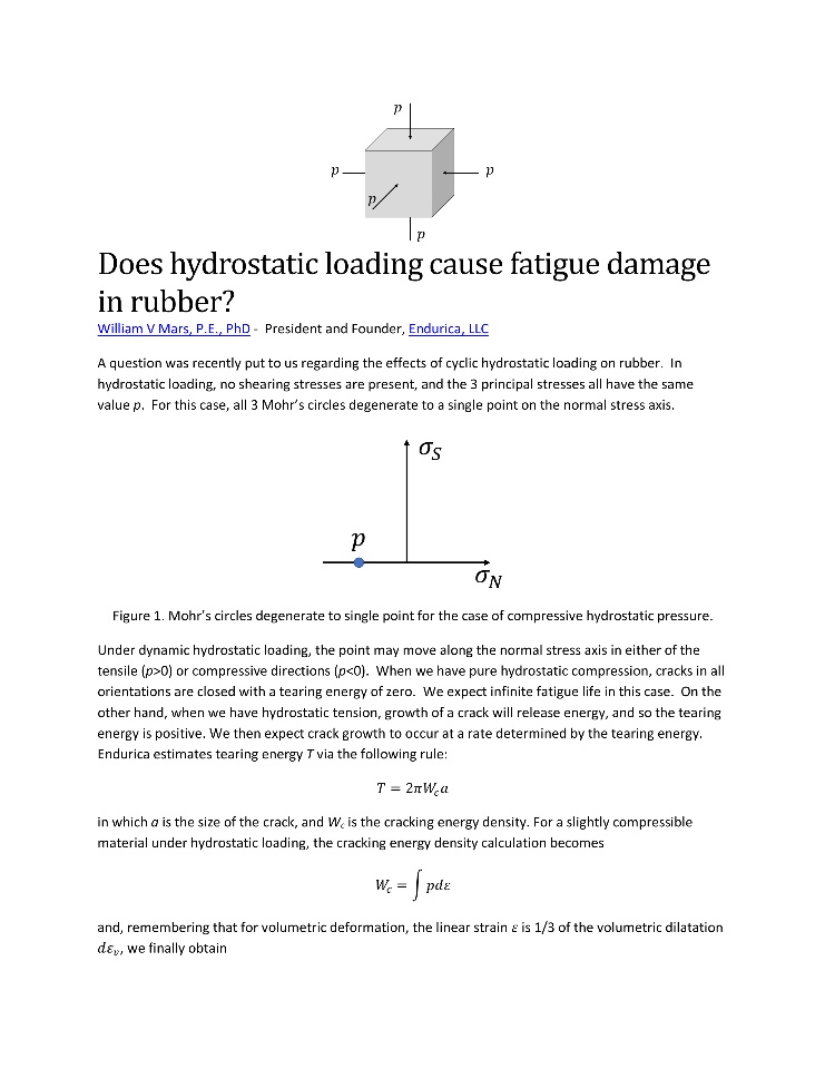

Does hydrostatic loading cause fatigue damage in rubber? By William V. Mars, P.E., PhD, President and Founder, Endurica LLC
A question was recently put to us regarding the effects of cyclic hydrostatic loading on rubber. In hydrostatic loading, no shearing stresses are present, and the 3 principal stresses all have the same value p. For this case, all 3 Mohr’s circles degenerate to a single point on the normal stress axis...please click on linked document for complete information with technical illustrations.
