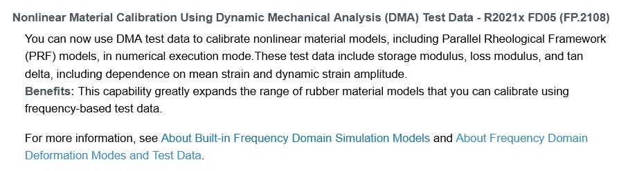

from the R2021x (FD05) "What's New" docs:

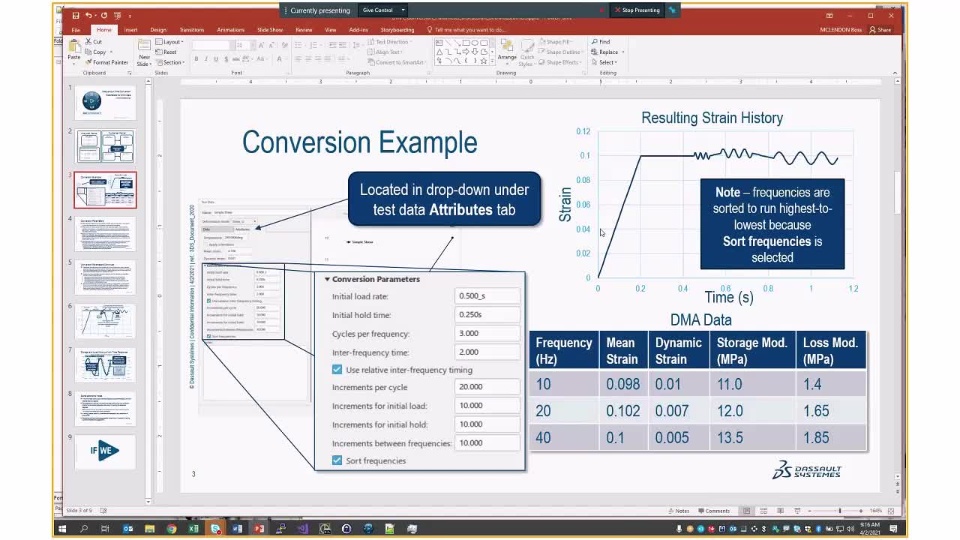

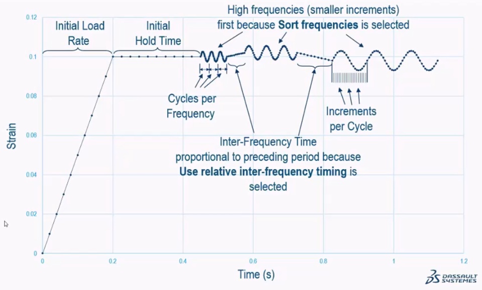

Back in April of 2021 we held an internal presentation of this calibration app new feature to a group of beta testers. Ross McLendon presents information on how the DMA conversion parameters are used to convert DMA frequency-domain test data into a time-domain signal.  The time-domain signal (time, strain) is used in numerical mode and A/Std is used to calculate the stress response.  Then the (time, strain, stress) signal is converted back into a DMA response for comparison to the test data.
Depending on the values of the conversion parameters and the number of points in the original DMA test data, the time-domain signal constructed may contain many points - this can significantly slow down the calibration process.
