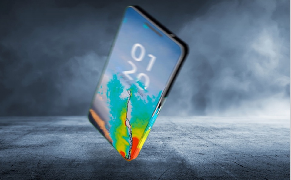

Devices are frequently dropped by their users, hence they need to be able to withstand these accidents without significant damage. Drop testing aims to find a design that is robust enough to survive everyday drops while still satisfying design KPI’s. A drop test simulation can vary design parameters such as material composition, thickness of screen glass, thickness of back cover, thickness of frame, corner radius and width of screen protector lining using a DOE methodology. Results include the deformation contour, Von Mises stress contour and plastic strain contour, plus 3D visualizations of deformation and cracking.
