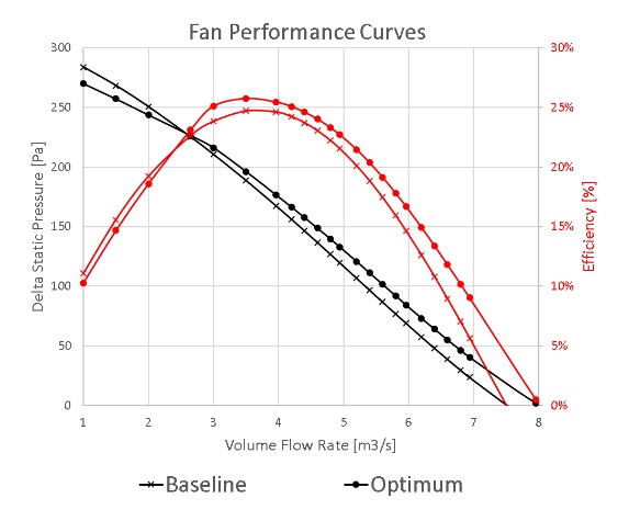

The fan performance curve can be computed from simulation in a couple of hours or from response surface (extrapolated from several DOE results) in order of seconds.  The curve in Figure 4 shows the improvement in pressure gradient and energy efficiency throughout the operating range for cooling tower for the optimized design. Each point on the curve corresponds to a simulation and each simulation is about 20 to 30 minutes. It is particularly critical to have higher efficiency over a wide range of operating conditions for fans with variable speed. Designing of such fans requires that aeroacoustics are captured and accounted for a wide range.
Figure 4. Fan performance curve

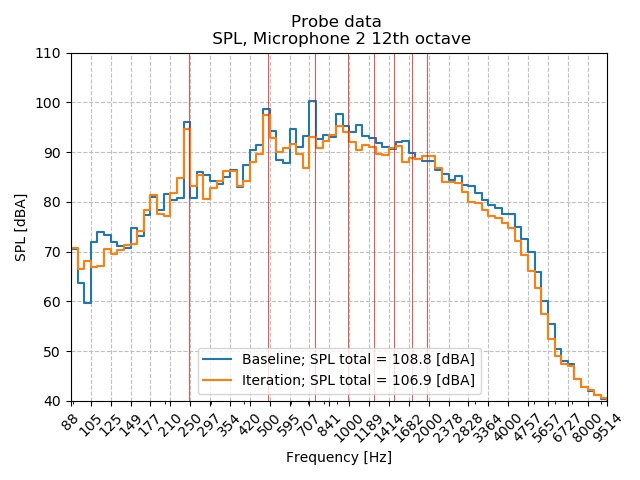

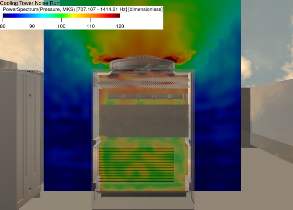

The aeroacoustic performance is assessed to measure the sound levels of the fan in study. Full 3D simulations are performed with the CFD solver PowerFLOW. The cooling tower is simulated with accurate representation of drift eliminator and the fill pack is simulated as a porous media. Both the baseline and optimum design are simulated. The CAD geometry of the new iterated design is imported into PowerDELTA template for tesselation of CAD and PowerFLOW ready surface mesh is automatically generated. If the automatically generated surface mesh is not PowerFLOW ready, then user has to manually fix the mesh using the editing tools in PowerDELTA. For most cases, the new simulation ready file is generated with ease by just replacing the baseline mesh with the mesh for optimum design for the fan. PowerACOUSTICS is used for the post processing of acoustic results. The comparison between the Sound Power Level (SPL) plots for two cases is shown in Figure 5.
Figure 5. Sound pressure level for baseline and optimum design

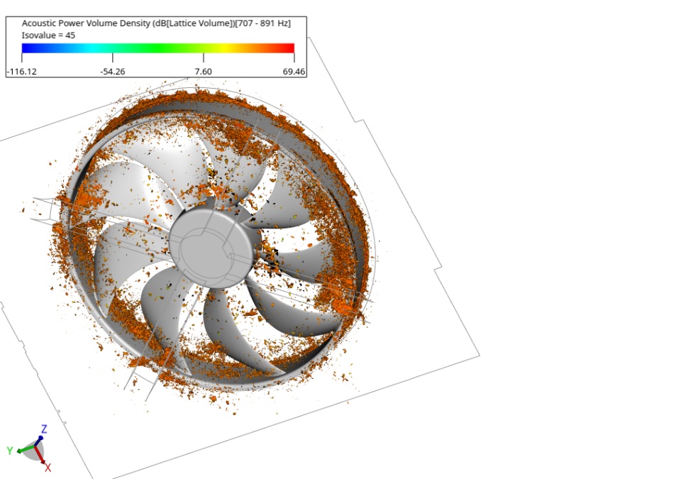

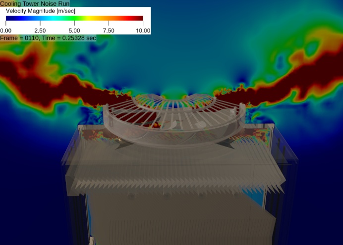

There is a reduction in tonal noise and overall sound pressure levels. Changes in blade tip leading edge and location of the fan affects the detachment of the flow and therefore has an impact on tonal noise. Broadband noise sources can be identified using Flow Induced Noise Detection (FIND). Areas of high acoustic power are identified as shown in Figure 6. Surface fluctuations of rotating geometries can be assessed using rotating power spectrum (RPS) as shown in Figure 7.
Figure 6. Acoustic power volume density isosurfaces obtained using the method FIND

Figure 9. Velocity fields showing the progression of air flow

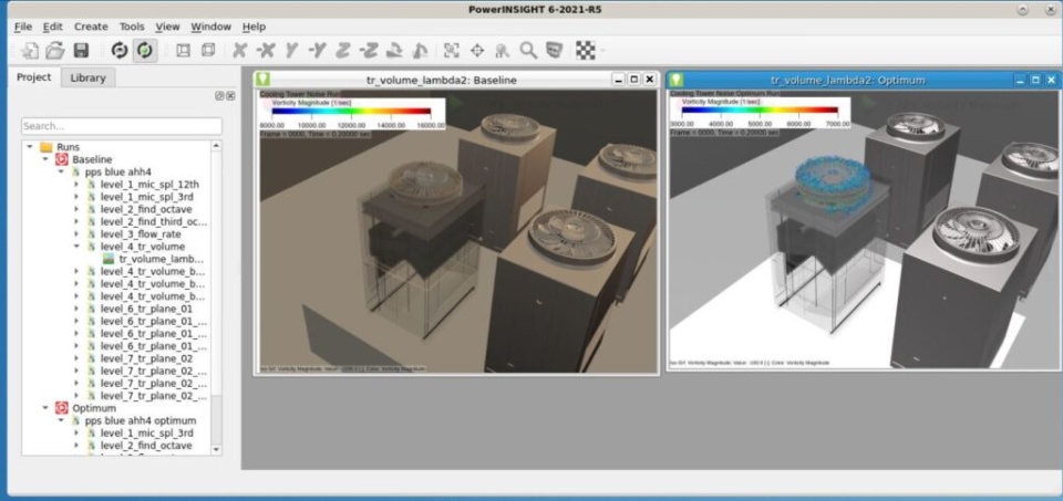

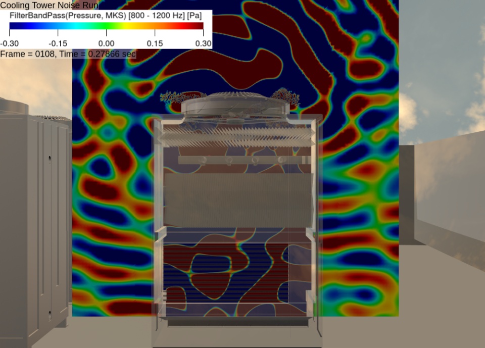

Courses on FIND and rotating power spectrum are available on learning center. Band pass filter for the frequency range of interest can be used to identify the location where the acoustic waves are emanating from and their interaction can also be seen as shown in Figure 8. Velocity and dB maps profiles are shown in Figure 9 and 10 respectively.  The results can be visualized and compared in PowerINSIGHT with ease. An example is shown in Figure 11.
Figure 11. Comparison of results for baseline and optimum case shown in PowerINSIGHT window

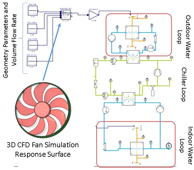

Last but not the least, modeling the integrated HVAC system of a building with its components installed in operating conditions is essential to achieve a truly efficient system. Dymola is used for system modeling solutions. The HVAC system performance is represented as a set of 1D reduced-order model nodes. The system model shown in Figure 12 represents the HVAC assembly with three loops namely Outdoor Water Loop, Chiller Loop and Indoor Water Loop. Fan is represented for Cooling Tower in the Outdoor Water Loop. The response surface of the fan with performance varying as a function of its geometry changes, is used to represent the fan performance in the 1D model. Energy consumption is measured accordingly. Modeling the integrated system enables the computation of equipment efficiency, for example EER and SEER [14] and can be then used to meet the rating requirements.
Figure 12. System modeling of full HVAC
The example in this study demonstrates the effectiveness of modeling the integrated HVAC system and shows coupling with 3D CFD is essential to achieve an optimized system using the tools of Dassault Systèmes while balancing fan operating efficiency, costs of development by analyzing several fan configurations, acoustics comfort and energy efficiency. A separate comparative study also presented the usage of system modeling and 3D CFD for balancing human thermal comfort, IAQ and energy efficiency. This was presented at Nafems World Congress 2021 [15].
