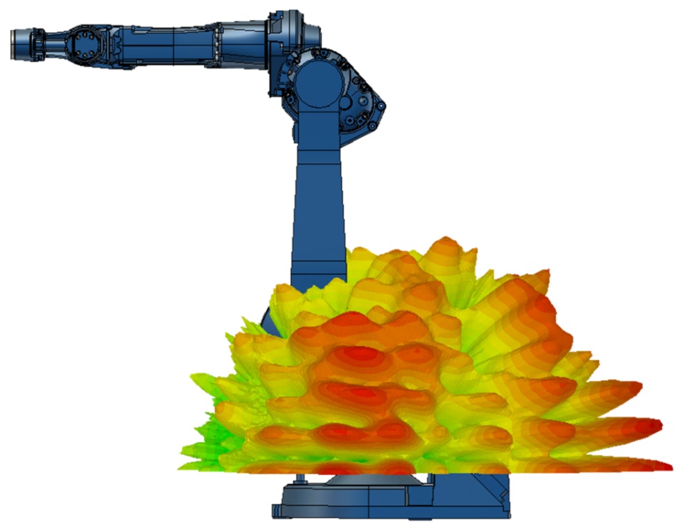

IIOT robots need to be reliably connected to the local network. Different antenna positions need to be simulated to ensure connectivity under all operating conditions

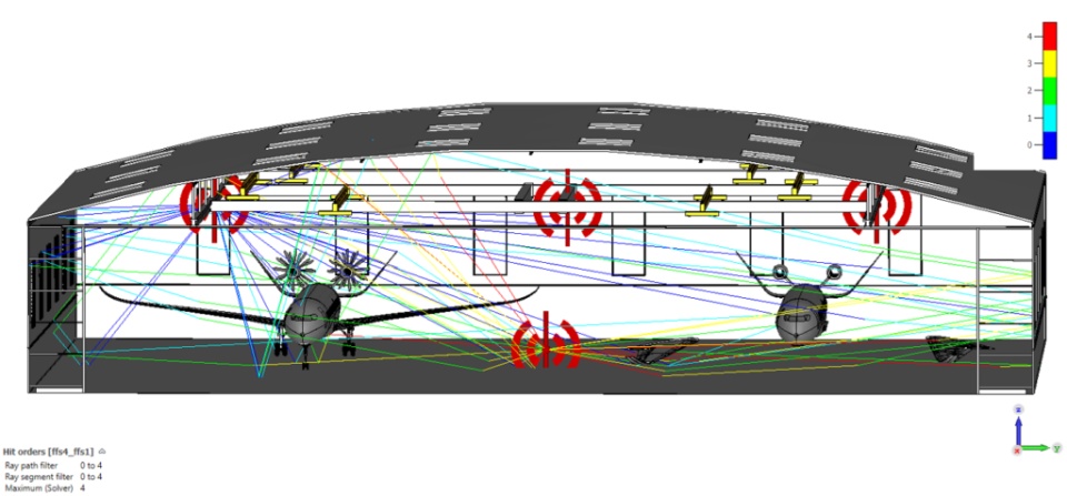

Assess network coverage in a hangar: state-of-the-art solver to predict shadow regions in complex environments

Dassault Systèmes offers a solution to facilitate the planning of agile private 5G networks. It not only allows manufacturers and other stakeholders to design optimal 5G access points – the electromagnetic simulation technology from the industry-leading SIMULIA softwareCST Studio Suite, also calculates the propagation of electromagnetic fields through complex 3D environments. The full wave behavior can be modeled, including reflections and diffraction, to capture multiple-input multiple-output (MIMO) and multi-path propagation. The channel impulse response can be calculated to determine the connection’s quality.
By interfacing with the operational planning and simulation tools and the CAD tools from the DELMIA and CATIA brands of Dassault Systèmes respectively, network planners can consider how propagation and coverage is affected as machinery moves and spaces are reconfigured. For example, in an aircraft hangar, simulation will show not only whether there are areas of poor reception in the shadow of the aircraft, but also how these shadows change as aircraft or AGVs move within the space. In a smart factory, simulation shows 5G propagation and coverage for different assembly line configurations.
