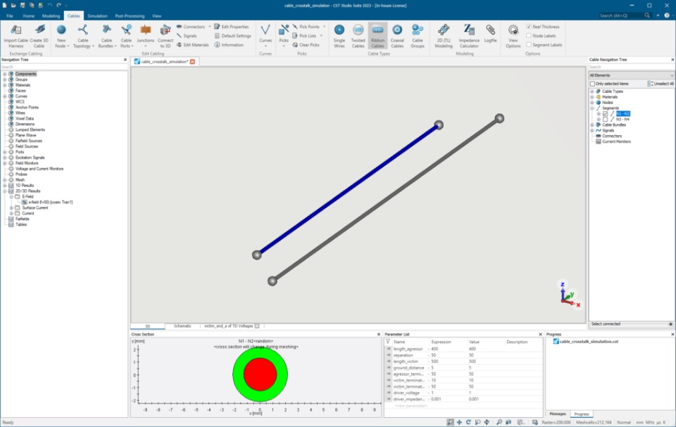

Image 1: Cable simulation model in the CST Studio Suite®

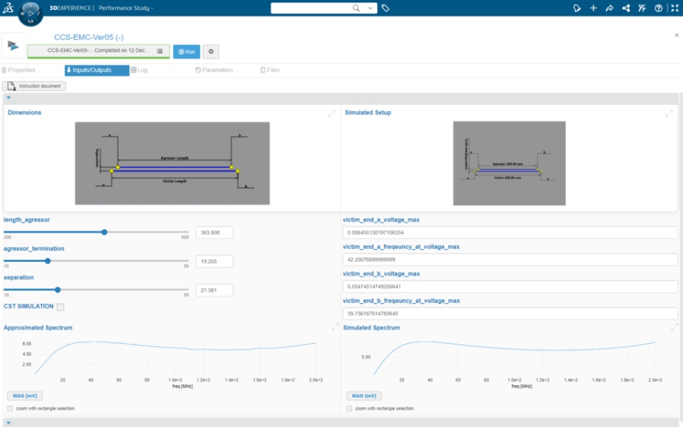

Typically, a simulation analyst will set up the electromagnetic simulation model and make sure that all simulation settings are correct. Then, they will build a dashboard to interface with the simulation model and publish this dashboard to colleagues that would like to run this simulation (App: “Process Experience Studio”).
Image 2: Web-based cable simulation dashboard on the 3DExperience platform.
In this example, we have chosen the electromagnetic simulation of cable crosstalk as a demonstration model. The simulation was set up inCST Studio Suite. It consists of two cables: one aggressor and one victim. The distance between the cables, the length of the aggressor and the termination of the aggressor were parametrized. The results of interest are defined as the crosstalk at the ends of the victim cable. We calculate the maximum value of the crosstalk in Volt and also the frequency at which this highest crosstalk occurs. For the input parameters, simple sliders will be used on the dashboard.
The dashboard offers two ways to obtain simulation results:
  1. A direct simulation of the model: The simulation model will run directly (on the cloud or locally) and the simulation results are displayed in the browser. This is the most accurate approach as the simulation with the given input parameter is executed.

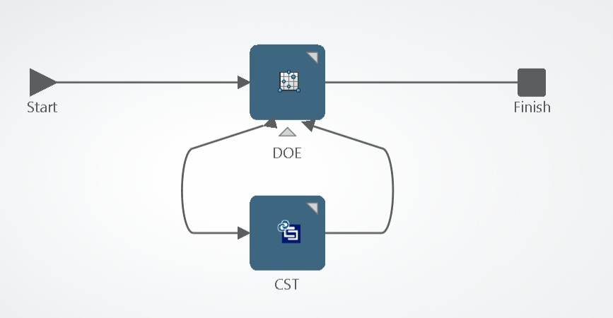

The generation of the approximation is performed using the app “Simulation Process Composer.” It is a design space exploration type of simulation where the input parameters are chosen according to an algorithm (Full Factoral) and the generated results are fitted using Radial Basis Functions (The Result Analytics App offers different methods to fit the results). Once the approximation is generated, it can be saved and evaluated through the dashboard, which takes only a few seconds.
Image 3: Set up of the DOE in the Simulation Process Composer

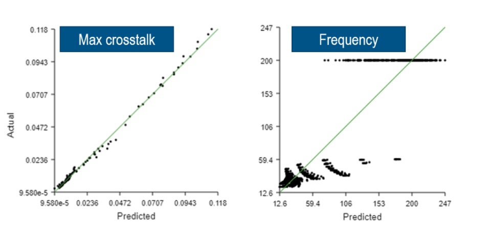

One of the problems we have encountered during the generation of the approximation is that the output results behave differently. For the maximal value of the crosstalk, the approximation works excellent. However, for the frequency at which the maximum crosstalk occurs, the approximation is not accurate. The reason for this is how the data behaves: max crosstalk is a smooth function but the frequency of max crosstalk is not. For certain parameter values, the max crosstalk is in the frequency band we have defined, for others, it is at the upper end of the band. This leads to a non-smooth behavior that is not well approximated by radial basis functions.
Image 4: Accuracy of the prediction model. Left: great prediction of the maximum crosstalk. Right: poor prediction of the frequency at which the max the maximum crosstalk is observed.
In order to solve this problem, we have decided to first calculate the approximation on a number of frequency samples (100) and extract the frequency at which the crosstalk occurs from the approximation. This is numerically much more stable and delivers reliable results. It also allows to plot the complete approximated spectrum and not only the frequency at which the maximum occurs. The generation of the approximate model at such high number of sampling points was automatized using a Python script. This is the nice thing about process composer, it allows you to plug in your own post-processing, for example, by Python but also Excel and so on. Once this was done, we have a really nice simulation dashboard that is very easy to use. Also, we have added a functionality that generates an image from the simulation model to inform the user about what they actually simulated.

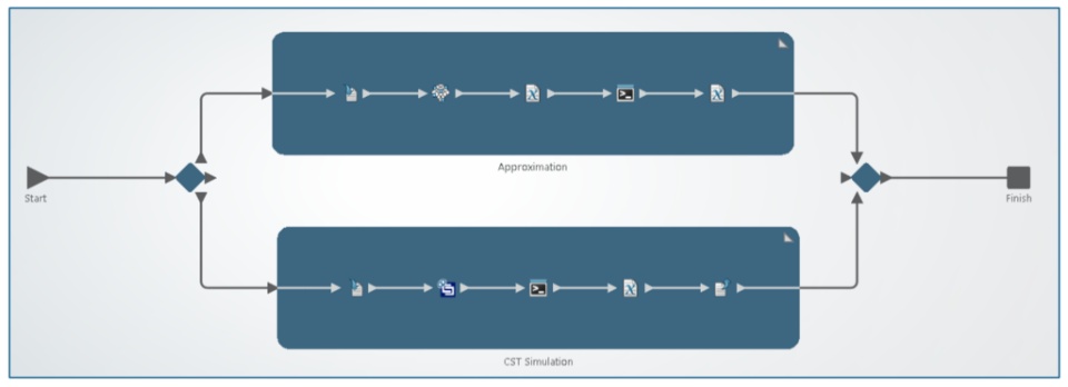

Image 5: The complete simulation process behind the dashboard as defines in the Optimization Process Composer. It includes the selection of the method (approximation or direct CST simulation) and all scripting required to predict the frequency at which max crosstalk occurs.
