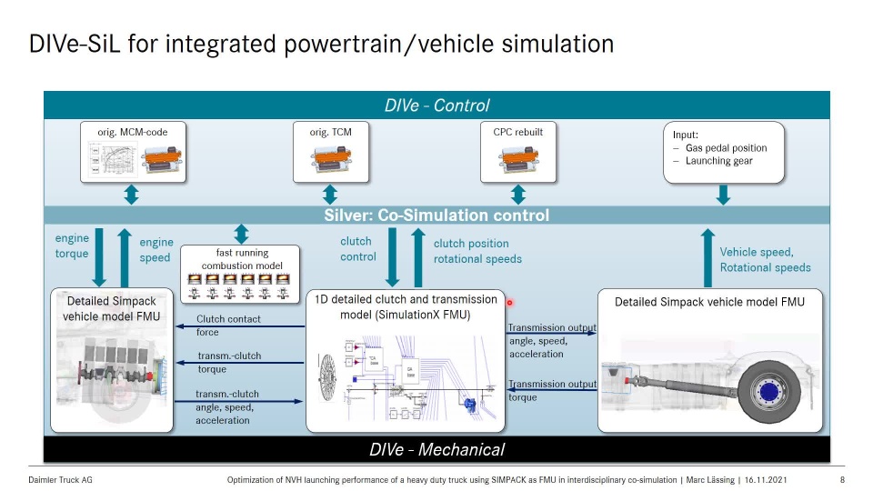

During the MBS Tech Days 2021, Marc Lässing from Daimler Truck held a presentation titled "Optimization of NVH Launching Performance of a Heavy-Duty Truck Using Simpack as FMU in Interdisciplinary Co-Simulation".
Modern trucks today use mainly automated manual transmissions, including automated clutch control. Launching behavior primarily depends on electronic clutch control and various hardware parameters like clutch friction behavior or clutch friction pad stiffness. To optimize the launching behavior regarding NVH and the performance, a full vehicle model including ECUs for engine, clutch, and transmission control was created, using Simpack as FMU inside an in-house co-simulation tool. Hardware parameters and software versions were evaluated to improve the launching behavior.
